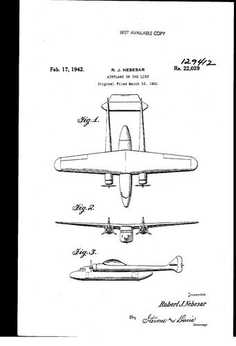

https://patents.google.com/patent/USRE22029

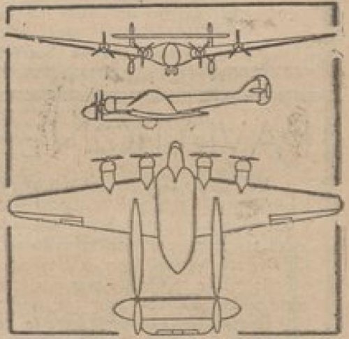

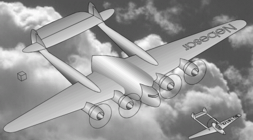

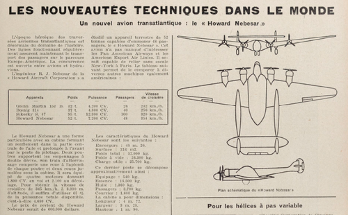

P.P:S.: Accordding to Němeček, Nebesář spent some time in the Martin, Lockheed and Consolidated companies and had complete trust of the Škoda company, owner of Avia. His first project was Avia 50, sort-of Lockheed Vega copy from 1931 and precursor to the Av-51, five-passenger machine with T-shaped tail surfaces and three Avia R-7 engines. Another Vega-like machine was Av-56 with one Avia Rr-29 radial engine, which after the engine switch to Avia HS 12Ybr led to afore-mentioned Av-156. The last project mentioned is Av-58, obviously a precursor for Av-158, a two-engined fixed-wheel monstrosity with Avia Rk-17 engines mostly similar to the LACAB Doryphore, if it was a low-wing monoplane. In 1937 Nebesář worked on Avia 63, Czech variant of Potez 636 with single tailplane instead of twin. Due to the immaturity of the original machine, licence negotiation fell and work stopped. And as I thought, in 1938/1939 Nebesář emigrated and spent some time with various small US companies, including Howard Aircraft Co. for which he designed "typically Nebesar-like overblown project, ... five-engined trans-atlantic twin-fuselage passenger plane Howard-Nebesar".
