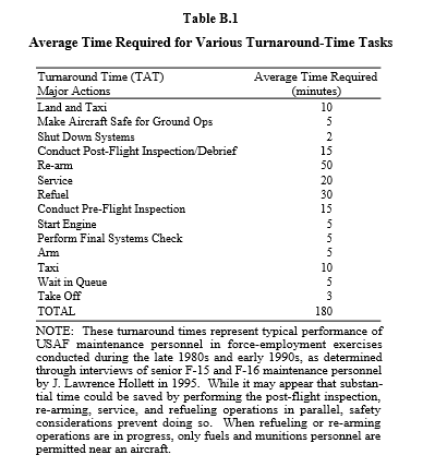

I think RAND has a paper on it regarding sortie generation rate.
They have a simple formula for maintenance time per sortie :
MT=3.4+0.68*FT
Historically we have Israel which manage to provide sortie rate of 4 sorties per day during 1973 war. This because not only decent training of their personel, short distance and development of new technique such as Hot-refuelling and rearming. It however also came with some risk as they cutting corners with safety. More typical ideal value would be 3 and 2 would be of normal.
Here i attached the part of interest.
  • 329517632-Rand-Sortie-rate-Model.pdf

Sorry but this is B**l**ks
Unless there is something seriously wrong with the F16. I worked fast jets and taught new groundcrew.
Re-arm 50 minutes, what your sending one armourer out?
Even allowing for a non-hot refuel/re-arm, you could do it all in 30 minutes. And I have never seen an aircraft need 5 minutes to start engines, 1 minute is plenty.
