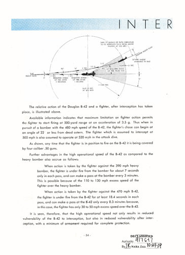

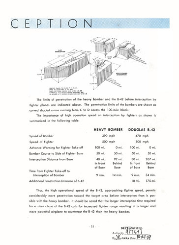

I just found something while reading about the Douglas ROC:
Preliminary design work was undertaken by W. B. Klemperer, who had come to Douglas from the Goodyear-Zeppelin Corporation. One of his early contributions had been an esoteric study of pursuit curves, a study pertinent to the Roc problem, but primarily applied to the interception of bombing planes. It was the philosophy expounded in this study which is exemplified in the latest Douglas bomber, the XB-42, familiarly known as the “Mixmaster.”
