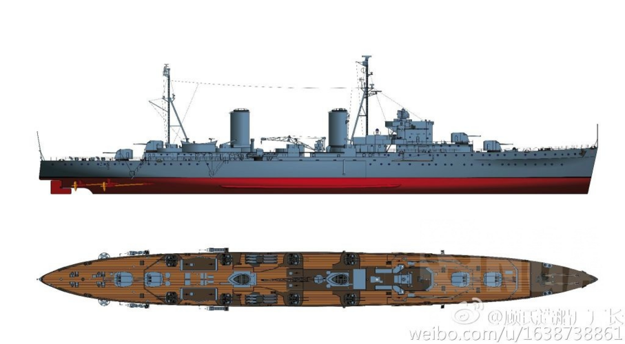

But the Soviets said it would be difficult to repair the 6-inch gun,So the Soviets proposed rebuilding four twin-130m guns and eight twin-57mm anti-aircraft guns,speed at least 30 knots
It costs 200 million rubles, four to five years,Chinese thinks it's too expensive(The total cost of all the Sino-Soviet naval treaties in 1953 was only 600 million rubles)

I don't remember where I got this, but its a very nice rendering of proposed rebuilt Aurora by the Soviets with 4 twin 130mm turrets and 8 twin 57mm anti-aircraft guns.
