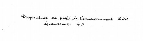

Can a French speaker please translate the text below. This is from a project blueprint and I am having a big problem working out the scale and dimenssions, for example it states that the length of the fuselage is 678, which makes no sense in either metres or feet. The clue is probably in this text. Thanks

"Profondeur de profil à l'encastrement 200
Epaisseur 40"
Can be translated as:
"Profile depth at (wing) root: 200
Thickness 40"

What type of aircraft is it ? 6,78 m is not necessarily a nonsense for the length of a fuselage. For example for the Arnoux Simplex racer (1923) the length is 5,40 m, and the thickness on the root would be around 40 cm.

As Orionblamblam says, the units may refer to a model, I had thought the same. It also says Echelle: grandeur on the drawing which I take to mean scale: full size, is that correct? If it were the span that had been set as 1 then the other dimenssions would be plausible, say 1 metre span and 67.8cm length. Unfortunately there is no reference to span on the drawing and no full top view.
Yes "échelle grandeur" means full scale.
Units on french blueprints are in millimeters, so that would be 67.8 cm. If the thing was 6.78 m long, it would be noted 6780.

Great, so we are looking at a drawing produced at full size and therefore of a model. All the dimenssions are thus in mm. Unfortunately there is nothing on the drawing to indicate at what scale the model was produced, I will have to see if I can deduce that from other information.
