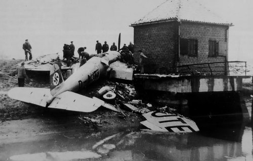

DanF - This forum is one of the few that I check out just about everyday. It is amazing what the members here come up with. Below is the cash photo from "An Industry of Prototypes – Heinkel He 119", Wings of Fame, Volume 12 by David Donald (1998). Clearly the aircraft is D-AUTE.
If you look at the pump shed you will notice damage to the railing, concrete, and gutter downspout. It seems fairly reasonable to conclude this is where the right wing hit.
Notice the visible prop blade looks undamaged. It is an indicator to me that the engine was indeed stopped when the accident happened.
Notice the cover on the top of the aircraft. To me, this cover looks further to the front of the aircraft than where the sliding cover is on V2 to accommodate the radio operator/gunner. It also looks like the front of it is a different shape. Perspective can be a tricky thing however. But certainly D-AUTE does not have the windows for the radio operator/gunner that V2 had.
Take a look at the left aileron (between the main standing behind the wing and the tail). The aileron on the original wing had a fairly constant taper to the outermost point, kind of like a steak knife. The redesigned wing and a much more rounded tapper to the outermost point, much like a butter knife. To me, the aileron looks like that used on the original wing.
Certainly the above is speculative and even a bit silly with knife comparisons and all. But, based on this photos and all the others, I am stuck in the belief that whatever aircraft D-AUTE was, it had the original wing.

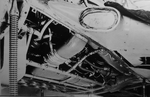

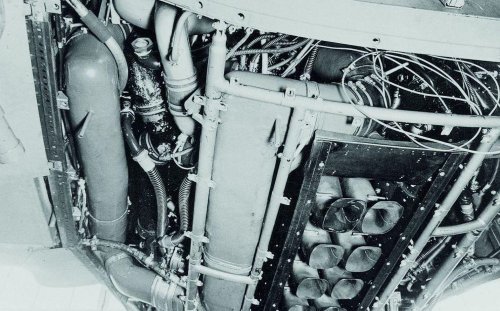

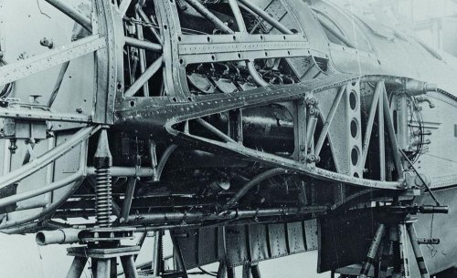

Regarding engine changes on the He 119, could the engine have been dropped out under the aircraft (again, purely speculative)? The widest part of the engine would be at bottom and given the layout of the aircraft, I think it would make sense to have it come out below rather than above. The engine sat a little in front of the wings, so the spar would have been behind the engine. I don’t see anything but the radiator in the way of dropping the engine out the bottom. Photo again from "An Industry of Prototypes – Heinkel He 119" Wings of Fame, Volume 12 by David Donald (1998).

Bill,
Thanks for posting the D-AUTE crash photo. It's amazing what a brick pump house can do to an airplane!. I really appreciate the size perspective it offers with people standing around/on the airframe. The machine is somewhat smaller than I imagined. Judging from the damage, it seems unlikely that airframe was ever repaired. Both wings are significantly damaged and the fuselage "backbone" seems to be broken. I conclude that if two He-119s went to Japan, then at V-4 landplane with redesigned wings must have been built.
With regard to the engine bay, I have seen the bottom photo before (It's also in the recent "He-100 Record Breaker" book by Erwin Hood). An interesting feature of the photo is that, although the lower surface service panels have been removed, the upper fuselage above the engine is also off. There is what looks like some sort of truss above the engine. On the He-177 the coupled engines were mounted to a central truss beam that connected their inner mounting attachment points. That beam was then attached to the face of the main wing spar and served as the primary load bearing support for the engine(s). Although I have yet to find any photographic proof, I believe a similar method was used in the -119 (as opposed to hard points on the stressed skin fuselage as in the -100 and -219)
The engine would ultimately have to be lowered to the ground to change it, but the question I cannot answer is how it was to be supported during that procedure. As you have no doubt seen, an He-177 engine change was done using a crane erected on the top of the main spar to support the weight and to allow raising/lowering of the engine. Again, I suspect something like that was used or planned for the -119. The only alternative would be a ground jack, but the Luftwaffe seemed to have a preference for cranes. In any event, there are obviously a lot of structure to be removed and systems to be disconnected, which would require open access to the entire engine bay. After removing the lower service panels and upper fuselage (as shown in your posted photo) there is not much left to support the forward glassed nose section, and the quarters inside of it for working on the forward face of the engine would be extremely cramped. As far as I know, the engine gearbox was the only rear support for the propeller driveshaft. What a mechanic's nightmare.

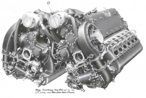

I doubt any -119 ever made it to the ~300 hr. TBO of the DB601, and I'm assuming that same interval applied to the 606. As far as I know, all -119s had the 606. The engine photo posted earlier in this thread is actually the later 610. The differences are subtle, but the gearbox casing of the 606 was smaller and more triangular while that of the 610 was oval shaped as shown.
Another interesting area is the outboard exhaust design. The V-1 design must have been motivated by a desire to keep the exhausts mounted to the engine while it was dropped out. The later V-2 style exhausts project through the sides of the fuselage and something (either part of the fuselage/wing junction or the exhausts themselves) would have to be removed before the engine could be lowered.

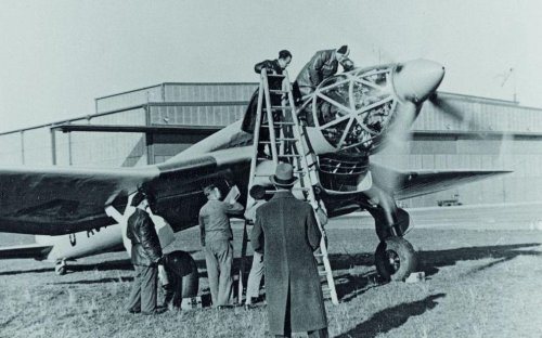

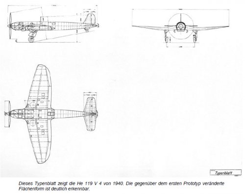

Hi! He 119
http://adl-luftfahrthistorik.de/dok/Heinkel_He119.pdf
http://www.klassiker-der-luftfahrt.de/geschichte/flugzeuge/rekordflugzeug-heinkel-he-119/584648?skip=1#1

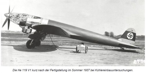

V1 retractable radiator.
I imagine that engine ram airintakes were located wing root leading edge and engine exhaust nozzles were located side of the fuselage and bottom of the fuselage.
http://www.do214.mega-forschung.org/html/db_606.html

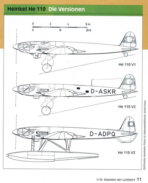

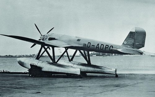

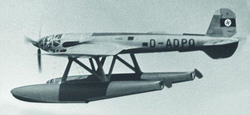

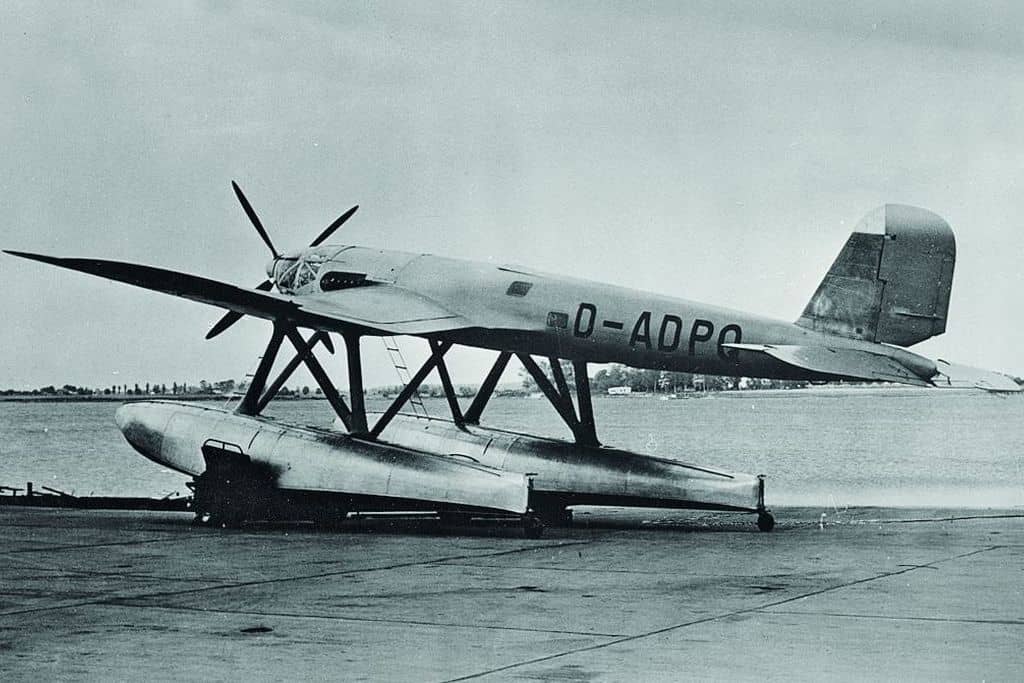

what heinkel he 119 was the V5?The seaplane one?Because some source say that the V3 was the seaplane and the other say that V5 was the seaple,I'm a bit confuse here and did you have any drawing or further information about the military version(if they were one)?
Even if I'll do the reco variant,I just want to be sure:Did heinkel wanted to do a reco seaplane variant or not(I know for the land one but the seaplane..not sure) and do you have any evidance about the existence of the he 519(because wikipedia...well :-\ ).
About the He 119 seaplane : You linked a source, that to my opinion is a very reliable one (http://adl-luftfahrthistorik.de/dok/Heinkel_He119.pdf)
and it only mentions the V3 as fitted with floats. As you can read there, the results were less, than impressive. A recce variant
is said to have been mentioned in December 1937 (project only).
That report concludes, that it was clear from the start, that no acquisition ofthe Heinkel type in relevant numbers was contemplated
by the RLM. The He 119 was an experimental aircraft, with a number of new features like coupled engines, prop driven via an extension
shaft and evoparitive cooling. Not quite surprisingly so, it suffered from a lot of technical problems and additionally from bad flight
characteristics and view from the cockpit.

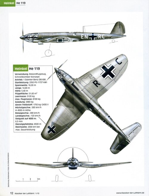

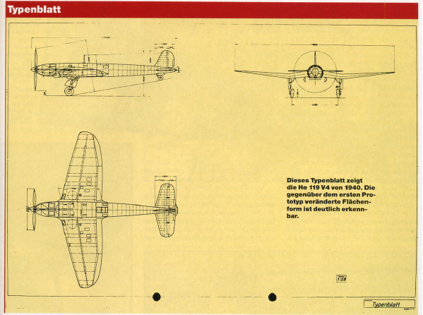

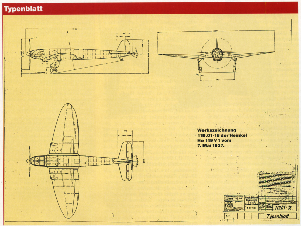

There was an He 119 article in 'Klassiker der Luftfahrt' of Januari 2010, the text and photos of which can be found on the 'FlugRevue' website:

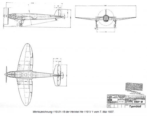

The drawings from that article are not on the website so I attach them here:
