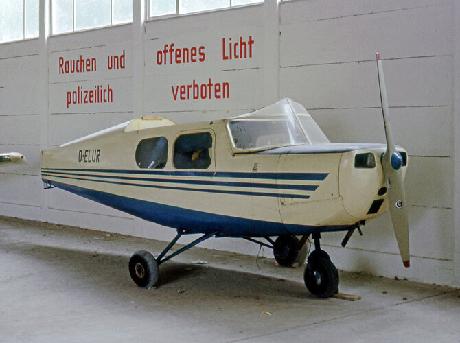

Also at 1953,he created HD-153 Motor Möwe,which was a side-by-side two-
seat motor glider high wing monoplane,powered by one 65 hp Continental
A65 engine,an improved versiom, HD-156 Motor–Möwen ,was a three-seat aircraft fitted with additional side windows.

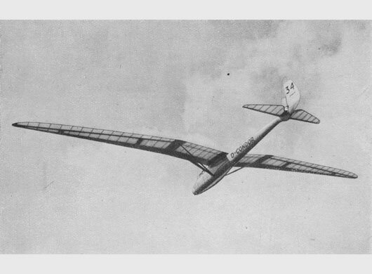

Dittmar (Schleicher) Condor - 1932 high-performance sailplane
- Condor : High gull-winged sailplane of wooden construction
- Condor I : 1932; single-seat braced-wing; span 17.26 m; x 5
-- Bley Flugzeugbau builds;* RLM designation Dittmar 108-48
-- * Excepting those self-built by Heini Dittmar & Peter Riedel
-- Condor I D-Prof.Dependorf; D-Günther Groenhoff 3; D-Käpt'n;
-- plus D-Ingenieurschule Weimar; and D-Hans-Hackmack
-- 1st prize Rhön Glider Comp.; world distance record 504.2 km
- Condor II : 1935; single-seat; braced-wing; span 17.24 m; x ?
- Condor II : Akin to the Condor I but with thinner wing profile
-- Built by Alexander Schleicher Segelflugzeugbau; RLM 108-56
-- La Falda: 1935 motor glider conv.; 1 x 18 hp Kroeber pusher

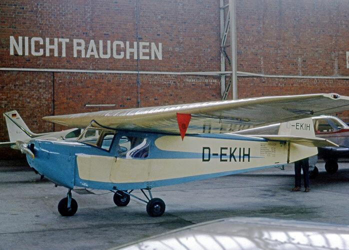

HD 153 - 1953 Motor Möwe side-by-side 2-seat motoglider; x 9
- HD 153: High-winged cabin monoplane akin to HD-53 layout
- HD 153: 1 x HO4 tractor engine (var. types); span 12.00 m
- HD 153: 1st prototype; Nov 1953; Continental A65 HO4
- HD 153: 2nd prototype; substituting 60 hp Hirth HM 60 HO4
- HD 153A-1: 1960 prod. 2-seater; 90 hp Continental C90-12F

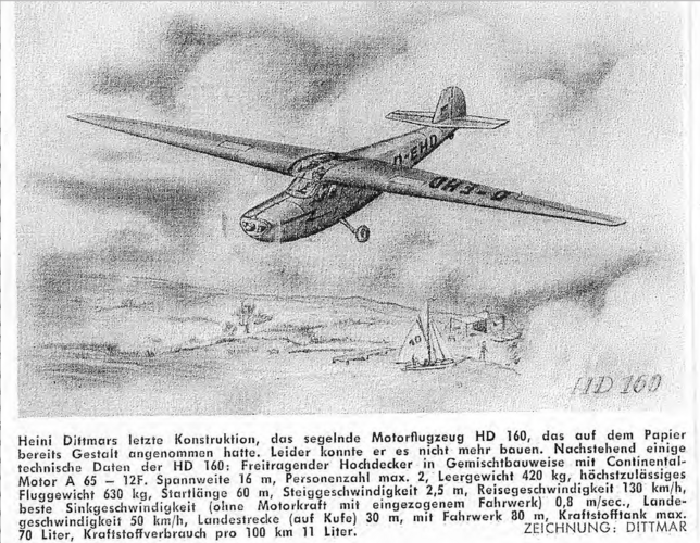

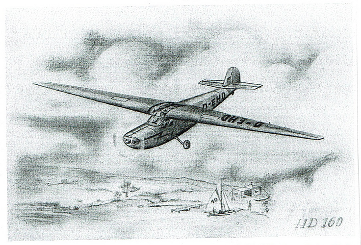

HD 160 - (Project) High-winged motor-glider; no details (??)
- HD 160 : 1 x 65 hp Continental A65-12F HO4; span 12.00 m
- HD 160 : As with HD 156B-1, prob. canc. w/ Dittmar's death

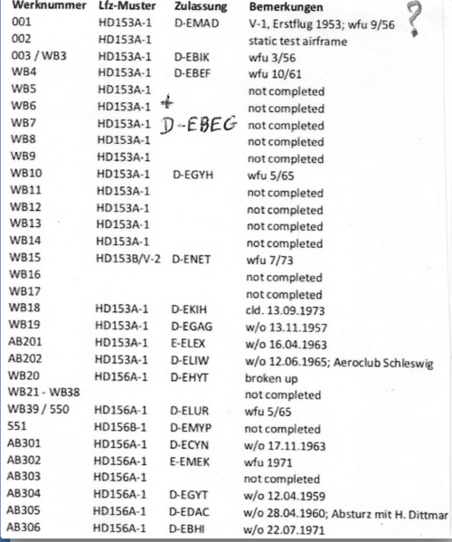

One more question: Can anyone explain the HD 153/HD 156 construction number system?
I note that "WB5 to WB9 [were] issued for amateur construction" but other WB serials were assigned (eg: WB 3 (D-EBIK). Amongst HD.156 serials, I see that WB 38 (D-EDYD) appears to be another intended home build which was never completed.
From there, I presume that production HD 153A-1s received AB 20x numbers - eg: AB 201 (D-ELEX) and AB 202 (D-ELIW) - while HD 156A-1s jumped to AB 30x numbers - eg: AB 301 (D-ECYN) and AB 304 (D-EGYT). Does anyone have any msns or other info that would disprove that assumed pattern? Thanks in advance.
Many thanks to you my dear Apophenia,and more Info about HD-160,
it was a two-seat cantilever high wing monoplane project,of mixed construction
with a Continental A 65-12F engine. Wingspan 16 m, empty weight 420 kg, maximum takeoff weight 630 kg takeoff,length 6 m,climb rate 2.5 m,Est. cruise speed 130 km/h.
Source for the last is "Der Flieger" , just before the death ok H.Dittmar

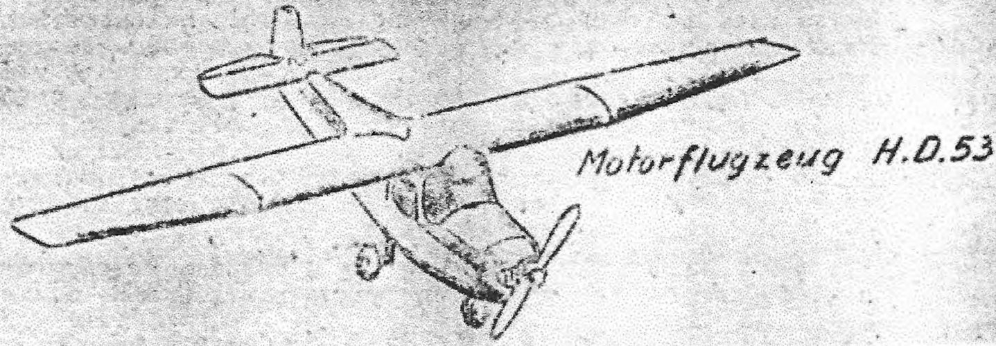

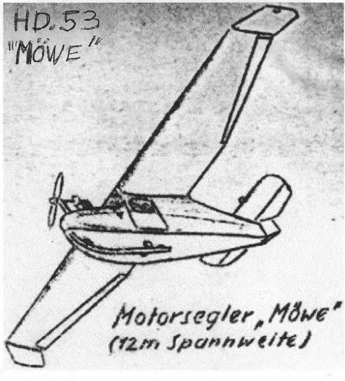

The captions to those images are very interesting. That captioned HD 53 „Möwe“ (12m Spannweite) seems to show a standard Möwe with wing tip extensions (which, coincidentally, give it the same span as the later Möwe. Then, in the imaged captioned H.D. 53 (which obviously shows an HD 153), those funky tips are gone. Cool stuff!
