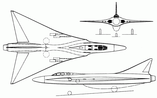

This drawing is from RAF Flying Review. I had the entire page at one time, but not anymore. It's not all I'm missing!. Who knows what model this is or even if it is Hawker?

That looks like an all weather development of the plane shown in the appendix of Tony Butler's book on British fighters. I'm at the office, so I don't have access to my books right now, but there is a plane in that book which is a single seat day fighter with a shock cone inlet in the nose and six cannons (three in each wing) IIRC with an almost identical wing and tail. I can check when I get home.
Hi ! :)
It's an Hawker P.1092 (05.11.51)
Rôle : all-weather interceptor
Engine : one Rolls-Royce
Span : 35 ft.
Length : 55 ft.
Wing area : 580 ft²
Crew : 2
Service ceiling : 55,000 ft.
Range : 550 miles
Max speed : 1.5 M at 36,000 ft.
Weapons : two red top AAMs
Sources :
-Combat aircraft prototypes since 1945, Robert Jackson, Airlife publishing ltd., 1985 (p.102)
-British secret projects : jet fighters since 1950, Tony Buttler, Midland publishing, 2000 (p.168)
Bye ;)
I know where is that page ;) (if you need a scan, just write me). Additional info:
Project status: Initial project design investigations completed by December 1951
Powerplant: Rolls Royce Avon with reheat
Internal fuel: 650 gal., 2925 l
Wing area: 580 sq. ft/53,88 sq. m
Leading edge sweepback: 65 degrees
Thanks to all for the info. I thought it might be the P.1091 but now I know better. Matej I'll contact you. Thanks.

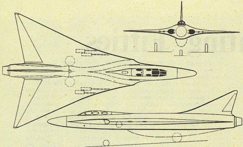

For the ones who likes to kwow the rest of the article:
Flying Review International Vol 20 No.1 September 1964
"The Frustrating 'Fifties " pages 67 - 69.

Greetings All -
I was recently given a couple of dozen tatter issues of Flying Review International that are from the early-mid '60s. In Vol. 20 No.1, there's an article called "The Frustrating 'Fifties" which covers a number of Hawker designs. Attached is P.1092 which I do not recall seeing before. Anyone have additional info ont he design and the Specification it was intended for?
Enjoy the Day! Mark

http://www.secretprojects.co.uk/forum/index.php/topic,1765.0/highlight,hawker+1092.html
Thanks Hesham, so much for my search techniques :-[
Enjoy the Day! Mark
