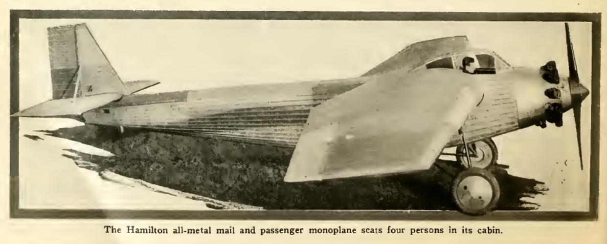

Also known as the Johnson-Hamilton Gyroplane.

It would be interesting to model the effect of the added props on the airflow around the wings.
And since there appears to be only a single engine, it would likely power either those or the front one. Then, assuming that by some magic that thing would actually leave the ground vertically, the transition should be interesting.

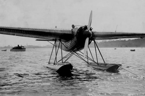

Anyway. The folks at Hamilton Metalplane seem to have a fertile imagination: I have the same contraption as a floatplane, sans underwing props.
The plot thickens.
(Photo & Naming Source: Dan's hard disk, from somewhere in the net, as usual)

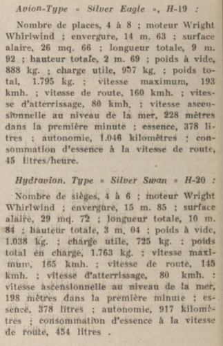

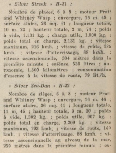

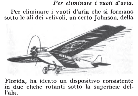

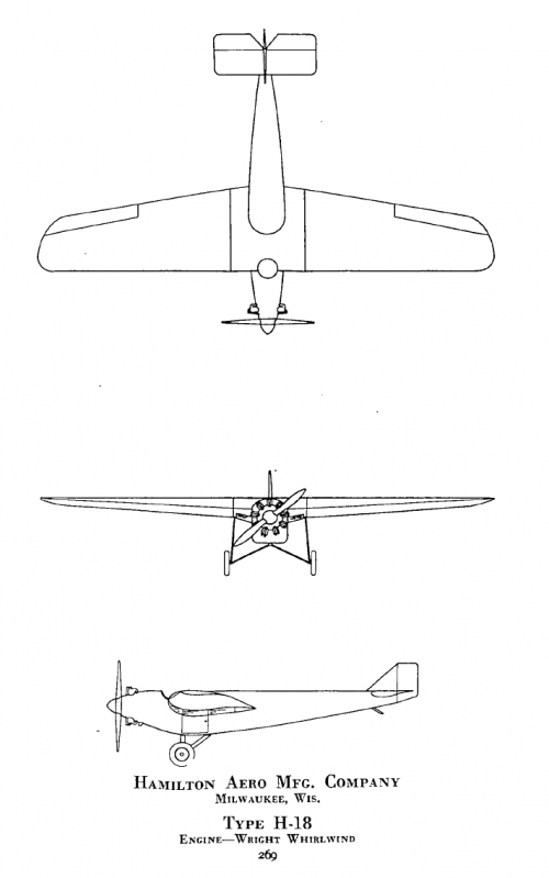

Hi Dan,
it was the same aircraft but converted into a VTOL aircraft as we see.
the Hamilton H-19 and H-20 were not known,so here is a small Info about them.
http://gallica.bnf.fr/ark:/12148/bpt6k9767475f/f584.image

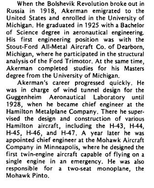

From, Of Struggle and Flight,
it's first time to hear about H-44 and H-46 ?.
Likewise for me with the H-46. I have the H-44 down as an unbuilt floatplane version of the H-43.
The H-45 was offered as either a landplane or a twin-float seaplane. Pure speculation but, perhaps, H-46 was an alternative designation for that H-45 floatplane?
