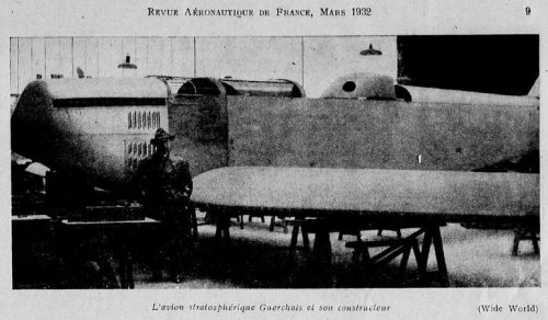

I came across this photograph of the Guerchais 110 avion stratosphérique in the Revue Aéronautique de France of March 1932. I have been able to trace little about this aeroplane, but it seems that it may not have been completed and did not fly. Neither have I been able to trace any information about its fate. Does anyone know anything more about it?

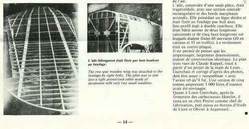

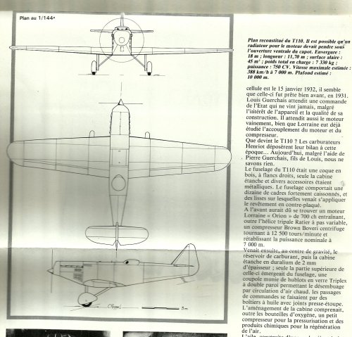

Hi Avion,
it was called T-110,and it was low-wing stratosphere experimental aircraft,powered
by one 870 hp Lorraine Orion engine.
HI AVION ANCIEN AND hESHAM
from and old "le Fana de l'aviation
Fantastic toura. This type is new for me.
You made my day.
Thanks, Maveric

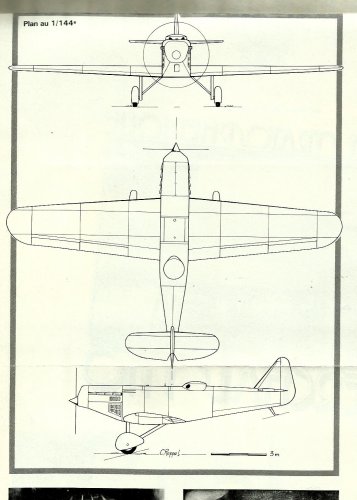

He Maveric
A better 3 views
Thank you, Toura, for posting a copy of the article from Fana. It seems to bear out my suspicion that the Guerchais 110 was not completed and did not fly. Sadly it sheds no light on what happened to the partially completed airframe. Chopped and burnt, I suspect!

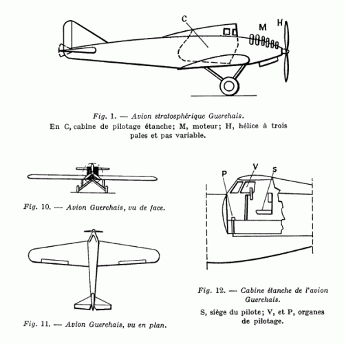

Several pics:
  • Guerchais holding a model of his "avion stratosphérique".

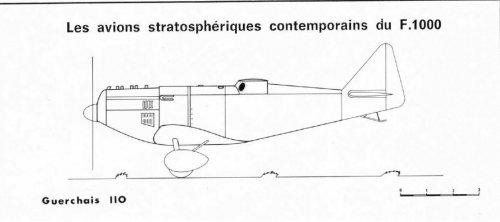

  • Diagrams from an old article of La Nature which described the Guerchais, Farman and Junkers stratospheric projects.

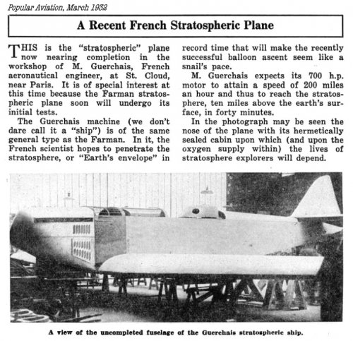

More still on the T.110, this time from the March 1932 issue of Popular Aviation:
may be that was the early drawing to Guerchais T-110 aircraft,not the different
from my dear Toura's drawing.

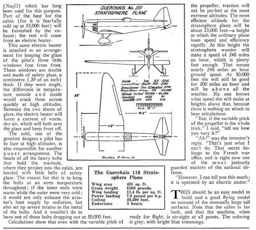

I just came across this article in a copy (Dec. 1932) of Model Airplane News. Hope it adds more fuel to the fire.... ;D
Regards,
John Braungart
Okay, for some reason the first page didn't make the cut, so here it is.
Regards (again)
John Braungart
