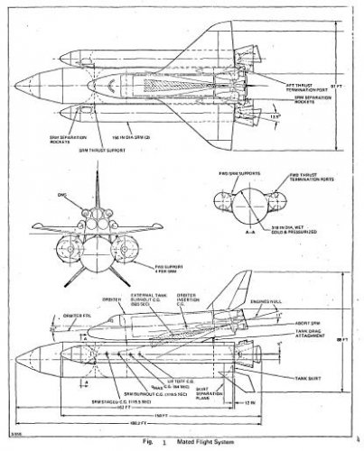

The intertank crossbeam for the forward SRB attach point looks interesting. It appears to pass horizontally between the LOX and LH2 tanks without going through the central axis of the intertank. Seems like a more efficient use of space than the final Shuttle ET.
