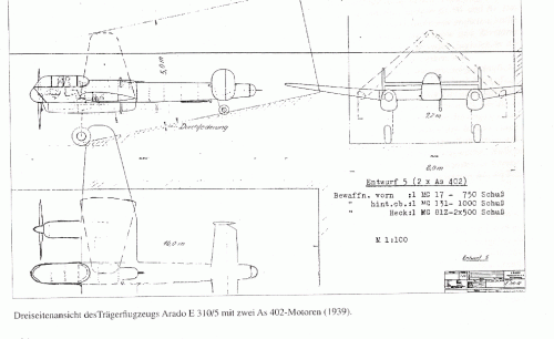

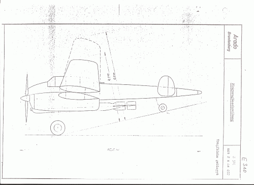

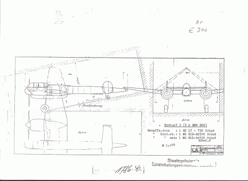

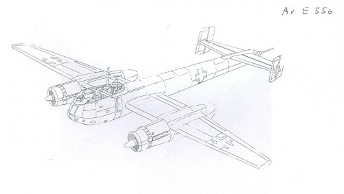

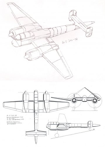

In 1938 the RLM issued a requirement to Arado ( and another company that I will not tell right now ) to design a successor to the Ar 195, Ar 197 and Fi 167. It would be a fast multirole carrier aircraft. Arado presented in June 1935 5 proposals, under the umbrella designation E310. Besides a 1940 single engined project ( http://www.secretprojects.co.uk/forum/index.php/topic,4516.0.html ) four with two engines such as the DB601, aS402, Jumo210 or BMW132. The version with As402 would attain 432Km/h, while the one with DB601 was predicted to achieve 630km/h. Range gives as around 800km, ceiling 5500m. There was, however, another version mounting the BMW800. Meanwhile, take a look. Pics taken from Kranzhoff`s book on Arado aircraft. More to come.

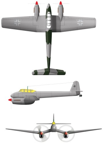

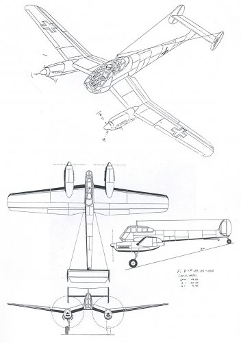

Here comes more. The other company was Fieseler. This maker produced at least two designs, the one above with inverted gullwing.

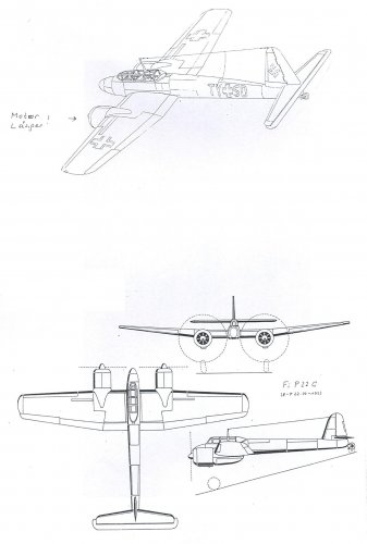

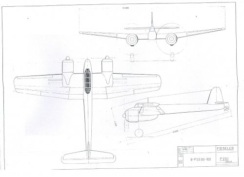

Just to add to this thread, the other Fieseler design ( not pictured ) is the 8-P22.00-102, or Fieseler P22C ( most certainly the third design ). Span 18m, lenght 13,2m, with straight wings and radials ( BMW800 is my guess ). The foldable wings had an articulation much similar to the Ju87C. Design is dated 28.4.1940. Bye.

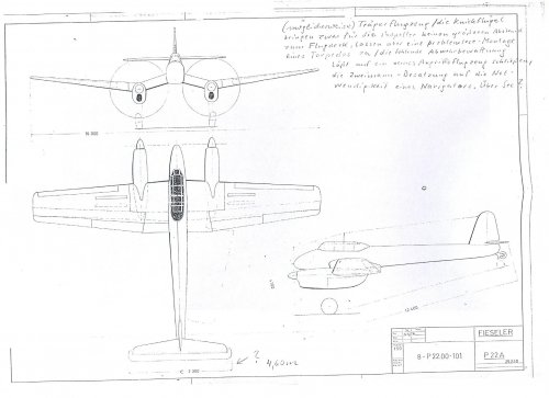

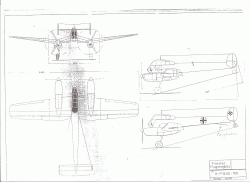

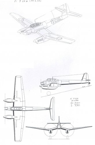

Here some Fieseler drawings obtained via Ingolf Meyer

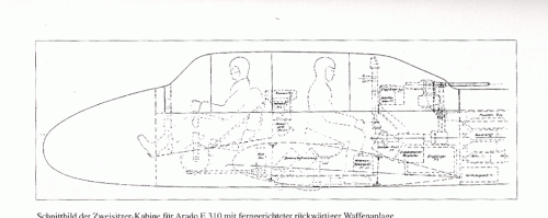

And some Arado drawings , via Ingolf Meyer

BMW 008s for the Fi 22C you say, any advice on engines for the others; Fi 8 P9, Fi 22A etc anyone?
Great thread.
Thanks to Ingolf and Justo too.
P
Hi Peter,
my best guess would be the Argus As402.
All the best

This is as far as I've got with the Fi P22A in photoshop.
The others are in various stages of key-lining etc.
Cheers
Peter

The Fi P8-19 to date too.
Peter

Regarding the Fi 8-P19 please.
Due to the year of the drawing, am I correct in assuming all movable surfaces would have been fabric covered? Plus where would any armament have been housed if any was planned?
Whereas the 22 A and C would have been all metal?

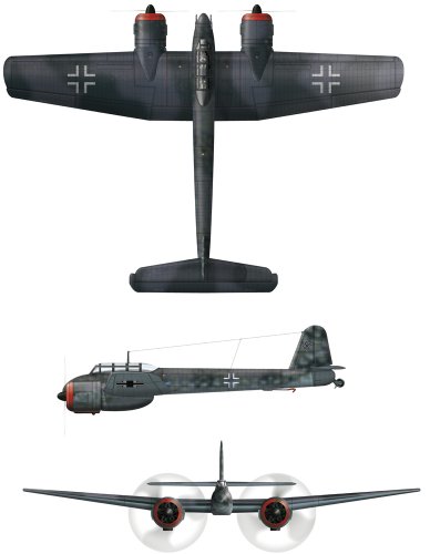

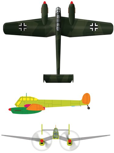

A little further progress.
I now believe the torpedos may have been left unpainted.
I chose to add the torpedo to illustrate one of the potential roles for a 'multi-role' aircraft.
However I am a little concerned whether this would suit, especially around the arrestor hook, tail-wheel and the torpedo?
Many thanks
P

more progress on the Fi P22A attached.
Many thanks
Peter

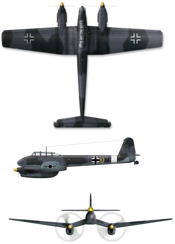

Another progress report, this time the Fi22C
Many thanks
P

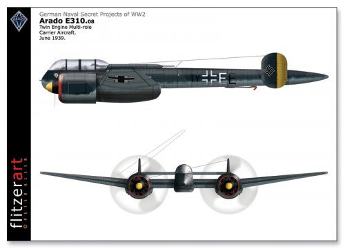

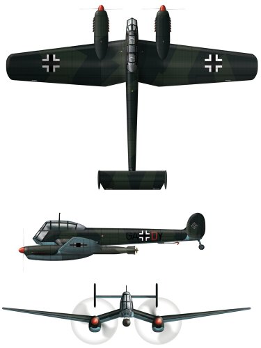

To complate the set so to speak, the latest progress report, this time of the Arado.
Many thanks
P

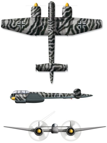

I've done a bit more.
Is there any more background history info for the Fieselers?
I've done more on those too. I will post soon.
Many thanks
P
