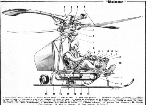

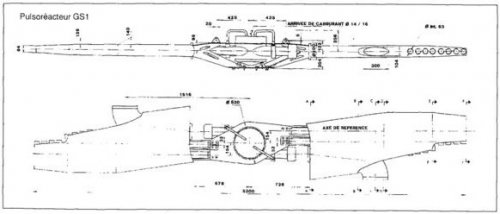

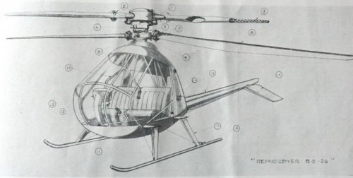

Found in Aero France, June 1958, a description and a drawing of the Rémicopter.
As far as I understand, the upper rotor was powered by the SNECMA pulsejets,
the lower one was there to control the aircraft.
And yes, the designer was R.Gaucher and the aircraft was built by the Société Reverchon.

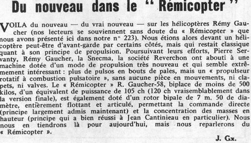

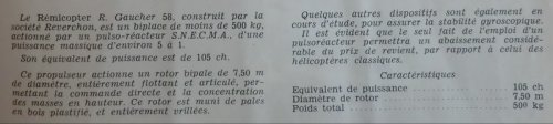

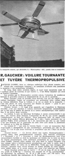

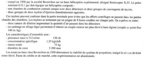

Here something more , from "Aviation Magazine" 1958 and 1959 :

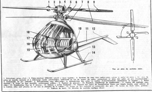

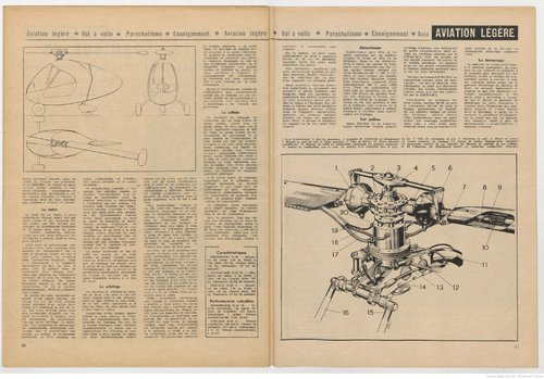

From Aviation magazine 1956,m
it seemed to be this helicopter had two variants ?.
  • Aviation_magazine___président-directeur_général_[...]_bpt6k5323416f_32.jpeg
  • Aviation_magazine___président-directeur_général_[...]_bpt6k5323416f_33.jpeg

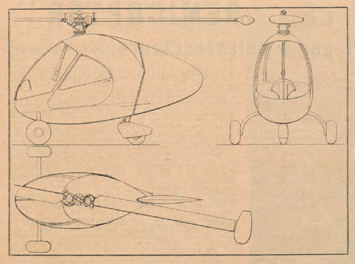

Yes, there were to be two stages to Rémicopter development ... but three different layouts.
The first was to be the Rémicopter X.50 (for 'experimental'?) powered by a Continental C-90 piston engine driving 7.50 m diameter, contra-rotating rotors. The X.50 had a pod-and-boom arrangement with tail surfaces but no tail rotor. Drawings show the X.50 to be a side-by-side two-seater.
Another was described in your article as the proposed single-seat prototype with a pulsoréacteur built into the rotor hub - as illustrated above by richard. With its simple, open framework this tailless aircraft was to have contra-rotating rotors like the twin-seat X.50. But it also featured simplified jet opening. Was this single-seater also to be designated X.50? I don't know.
The proposed production-type was the Rémicopter 602 which you have illustrated in that 3-view drawing. Obviously, the Rémicopter 602 was another tailless type but now single-rotored. Like the proposed prototype, this single-rotor type was to be powered by a SNECMA pulsoréacteur - in this case, either the Escopette 3340 or Écrevisse AP503 (aka AS-11) pulse jet.
