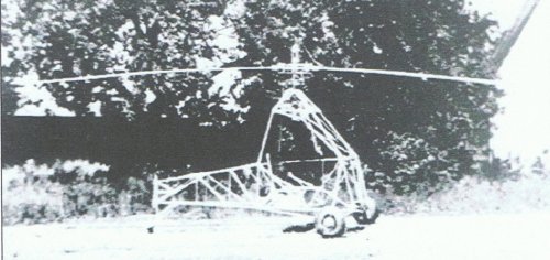

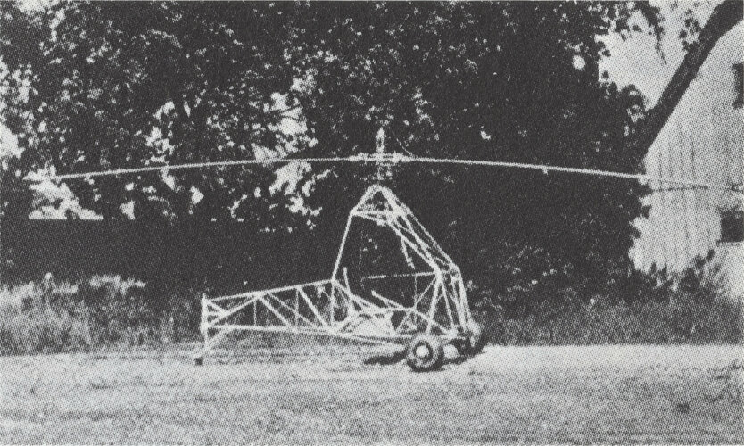

Somewhere on my harddisc i found this picture, uncredited
I think it was from a photo i took at the Buckeburg museum in Germany.

This is what I call "minimal design". Good as a demonstrator but questionable for the further development that led to the operational aircraft and practical use.
Greetz
Thanks, hugo007, for answering my old question. Did you take the photo inside the exhibition or in the archive?
Sorry,
It was on a visit at least 20 years ago,
with my lens against the display glass, and a basic text card 1947 Nemeth Helicopter Company.
In the same display case were pictures of the Ambi-Budd flying car,(no text at all)
and the Pentecost Hoppicopter.
Currently the Buckeburg museum is building a big extension,
when its finished i will be (hopefully) visiting again.

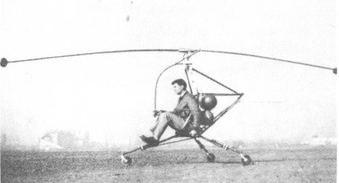

PS: I think the picture of Hugo007 may depict the Capital C-1 Firefly of Horace T. Pentecost and built by the Capital Helicopter Corporation and flown in March 1954.

Oeps,

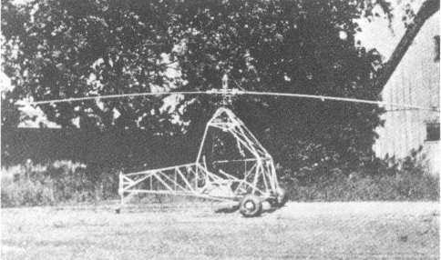

I'am so sorry, must have mixed-up the captions then, because that 2nd picture resides on my HDrive as
Pentecost Firefly, (here's almost the same pic. with a little more house or barn)
Thanks to all for disentangle the short-time confusion ;) .

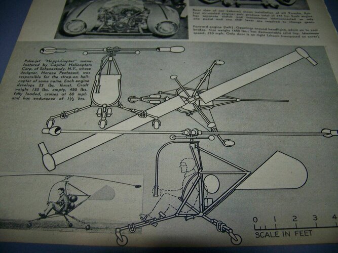

You are right. An article appeared on ebay depicting this very machine:
See also:

I am just diving into this helicopter. Apart from this forum an mentions in two books (one mentioned in opening post: "Technik und Geschichte der Hubschrauber" by Rolf Besserm; the second one is "Helicopters and Autogyros of The World" by Paul Lambermont form 1958), there seems to be nothing on it.
I have doubts, however, on the picture presented here. The books says that it is a two-person design - picture for me shows a single-person helicopter. The latter publication mentions that it had two main wheels and skid on the back and skid in the front - you may argue if picture shows skid or tiny wheel in the back, but there is nothing in front.
It could present a helicopter under construction, or something entirely different.
Does someone has any other materials to corroborate this picture authenticity?
Steven Paul Nemeth was from Chicago, Illinois. In the latter part of the 1920s, he was involved in the design of several cyclogyro types (none of which was built), but became mostly known for his "Umbrellaplane", a two-seat open-cockpit high-wing monoplane based on a lengthened Alliance Argo fuselage, fitted with circular wing for STOL performance, and powered by a 90hp Lambert engine. Also called the Nemeth "Roundwing", it flew in 1934 and was registered as the Nemeth "Circular Wing" [X13651, c/n 100]. Nemeth designed another airplane concept the following year, using a Nemeth-designed direct-lift device called the Levitator, but nothing came of it.
Steven P. Nemeth became chief helicopter engineer with Borg Warner during World War Two, and right after the war he created the Nemeth Helicopter Corp., in his native city. The company eventually became the Nemeth Aeronautical Laboratory. The only known model from Nemeth's company was the "Pauletta", a 1947 two-place anti-torque helicopter with ramjet engines at the tips of the single rotor's two blades. It was built, but there is no indication that it was ever flown.
Just to make things clear: the photo of a flying machine further up in the page is that of a Pentecost Hoppi-Copter. The open frame helo on the grass, however, is probably the "Pauletta".

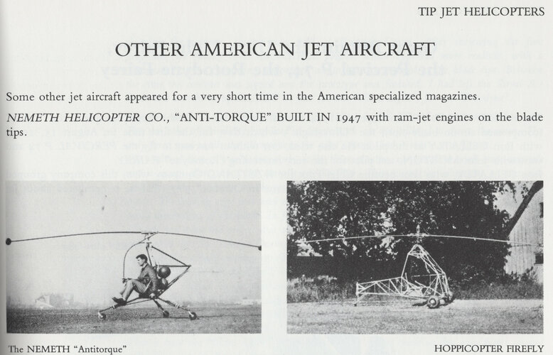

First of all, the mistaken photo in the second post here is most likely originating form the book of Mr Jean Boullet: History of the helicopter as told by its pioneers 1907-1956. There the Nemeth helicopter is mentioned, but picture is labeled wrongly:
There you have it: they inverted the captions!
