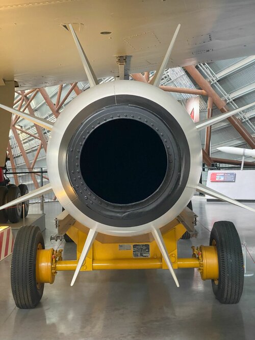

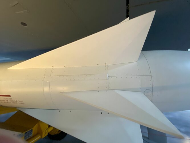

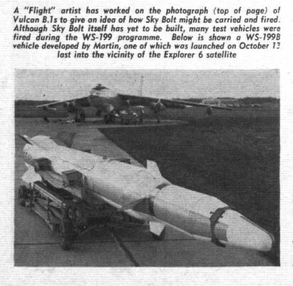

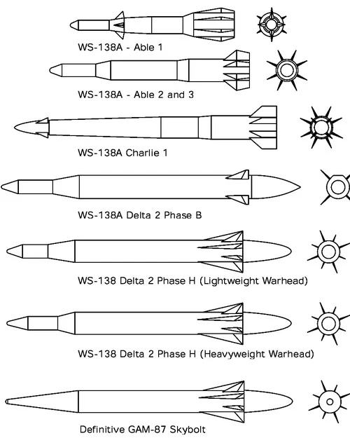

Canards were initially mounted on the second stage but were eliminated in March / April 1960 with the revised Skybolt Delta configuration. It is clear how the initial configuration drew on the WS-199 research vehicles ( second attachment ).
On the definitive flight configuration there were eight tail fins, but four were of shorter chord than the others. Those four adopted the function originally assigned to the canards, being used for the pitch & heading adjustment when the first stage fired.
Incidentally the KC-135 was also considered as a carrier.

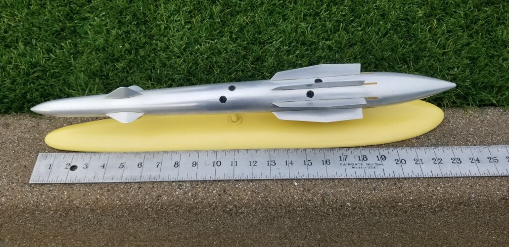

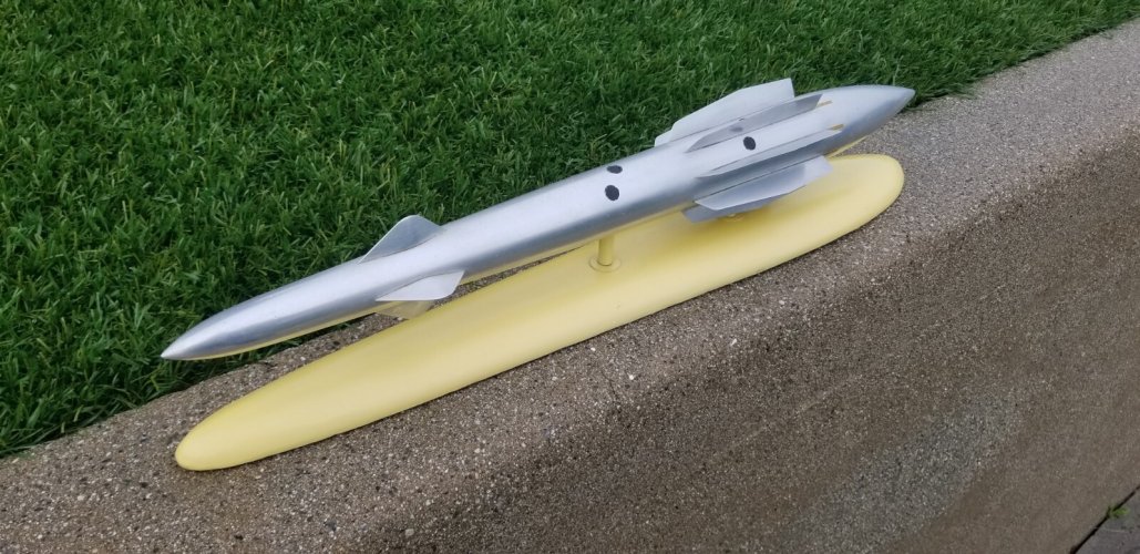

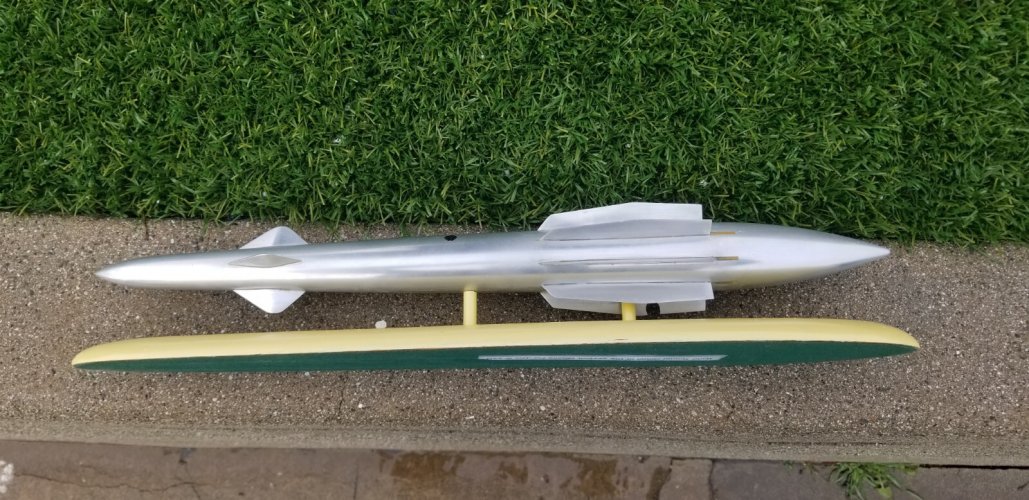

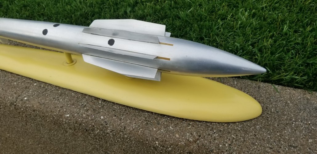

I found this while browsing around, It could be of some interest (if its legitimate)
https://www.ebay.com/itm/305387809968

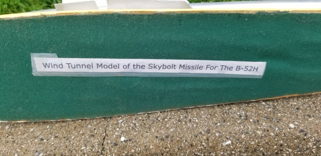

title: Douglas GAM-87 Skybolt Missle Wind Tunnel Model B-52H Aircraft Airplane Desk
almost looks like the Charlie 1 version of skybolt from this chart, but not entirely
douglas_gam_87_skybolt-88460-png.823558
( i found this chart here: https://svppbellum.blogspot.com/2020/03/il-gam-87agm-48-skybolt-era-un-missile.html)
