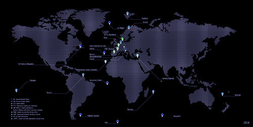

Given the cost of the thing, it's quite silly to be world wide spoofed at one time like that. But well observed, the ground station seems to have been the weak link targeted.

b. the system was not spoofed. There's a problem at one of the ground stations (I saw a report indicating a software update had gone awry) and because the system is not operational yet, redundancy has not yet been built for that particular function.

With the whole constellation affected, and reports of position errors of 500m, I suspect the 'ground infrastructure' involved was the ground-based reference clocks that generate Galilleo System Time.
