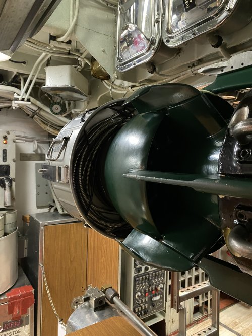

The wire is cut at the TMD so I'd assume that was to ensure no more wire remains in the tube before the muzzle door is shut.
The TMD here has the interfacing umbilicals connected and stays behind:
(I don't even think it would clear the tube. It's locked in place and if it came loose and got jammed in there things would be ugly.)
I was under the impression that the wire was cut at both ends (TMD* first then at the Mk-48 end).
*What does TMD stand for?
Yeah, it's cut at both ends but obviously we're really only worried about the trailing end fouling anything.
TMD is the torpedo-mounted device, I'm sure it had a more formal name but was always referred to as the TMD.

(edit, thanks to @FlameCxbra -- TMD is actually "tail mounted dispenser!" Either the torpedomen lied to me or it's been too long, there was nothing but trouble down in that room anyway...)

The TMD is the Tail Mounted Dispenser for paying out guidance wire.
Here is a patent for one
