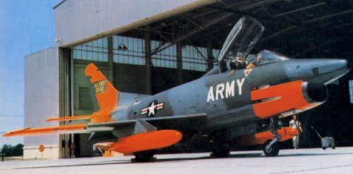

Little known is the Story that tells about a strong interest by U.S. Army about the G91, so stronger that Americans really tested the aircraft at Fort Rucker in 1961 (one or two aircrafts it depends by the source), as the photo I enclose testify (it is not a fake!!).
Did you folks have some additional information to this Story??

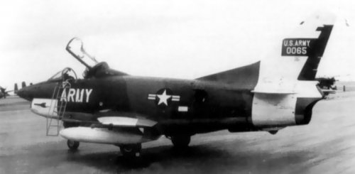

In 1961 the US Army tested two Dornier built G 91R/3s whilst in 1961/62 the USAF tested 2 to 10 G 91R/1s. The aircraft did not receive any serials but were flown in US markings with a construction number in lieu of the serial. Numbers of the US Army aircraft were 0065 and 0052.

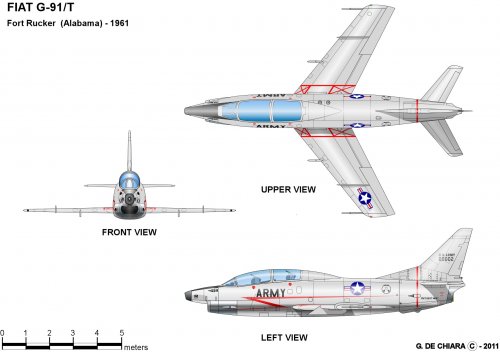

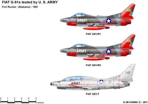

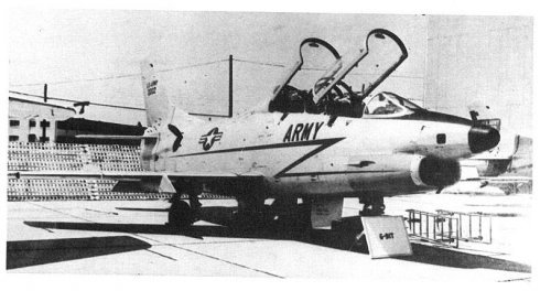

in fact US Army tested at Fort Rucker two G.91R-1 (construction numbers NC.42 and NC.52), a cannon-armed G.91R-3 (NC.65) and a G.91T (second prototype NC.2); during a test of short take-off assisted with ATO rockets something went wrong and the aircraft stalled abruptly, killing test pilot Riccardo Bignamini.
Event USAF evaluated the G.91 at Kirtland AFB (New Mexico) testing G.91R-1 NC.53 and a Luftwaffe G.91R-3 (I dont know s/n or c/n of the secondo a/c). I think that after the tests all serviceable aircraft were returned to previous owners.

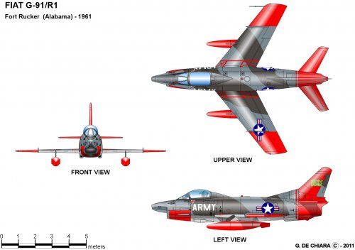

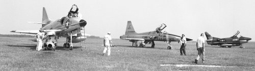

There were apparently three variants tested at Fort Rucker. Here are some photos I saved a while ago and some artwork by G. de Chiara:
