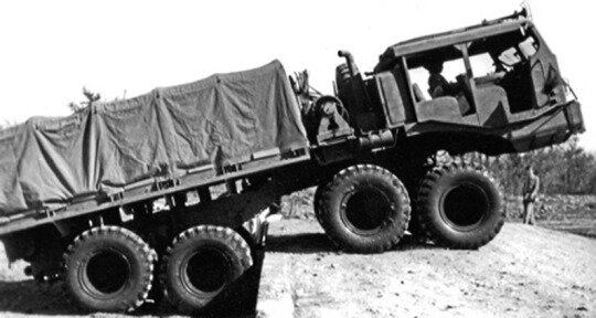

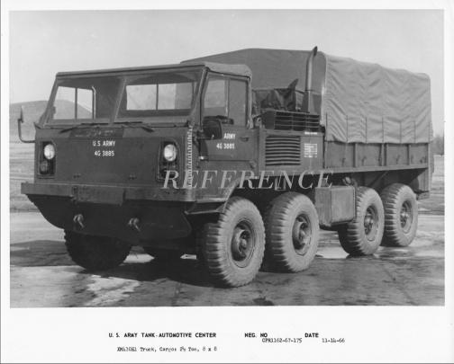

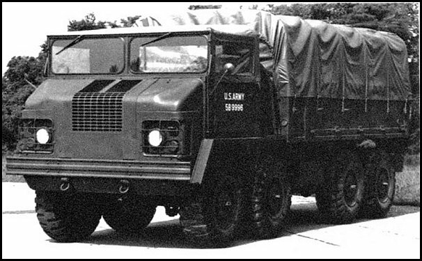

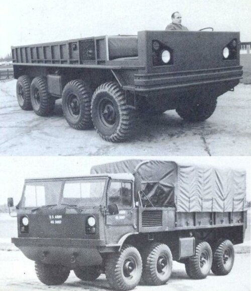

In scrolling through the list of U.S. military M-number vehicles, it looks like the Army trialed a large number of 8x8 cargo trucks in the 1950s until the Vietnam War or so. They vary in cargo rating, from 2 1/2 to 10 or so tons, not including oddities like heavy tractors, and some appear to have been developed for some kind of amphibious program? information is rather scarce, but it seems like the only one to enter service was Ford's M656, used by Pershing I missile units. So i'm curious if anyone has anymore information about these or knows what program they belonged to? The ones i've found are:
XM410 and XM410E1, Truck, 2.5 ton, Chrysler -Amphibious truck, View: https://youtu.be/e6B5ezE9WNs, Torqueflite automatic transmission, 361 V8
XM409 Truck, 10-ton, International Harvester
XM357/401 Truck, 4-ton, FWD -One of FWD's Terracruzers with low-pressure rolligon wheels. FWD Model 8-320B were bought by the Navy and Air Force, with the latter using the MM-1 designation for it when used as a specialist missile hauler.
XM453 Truck, 5-ton, GMC-Ford-REO -amphibious

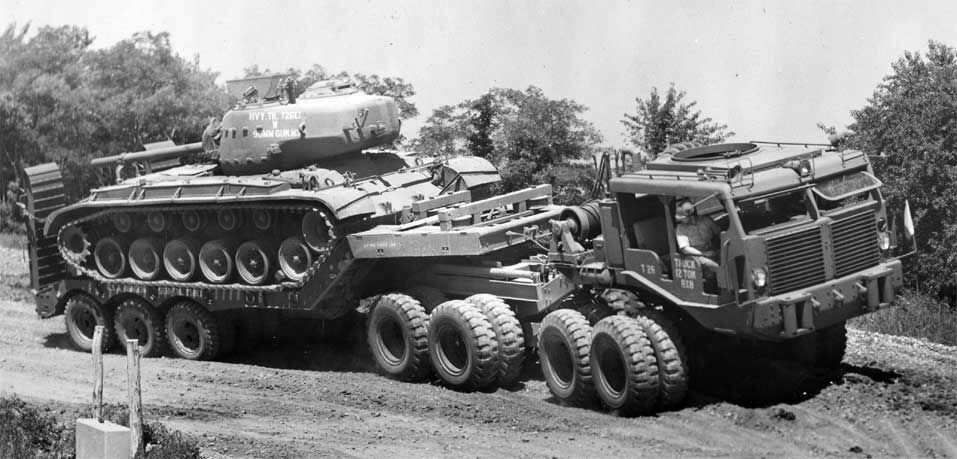

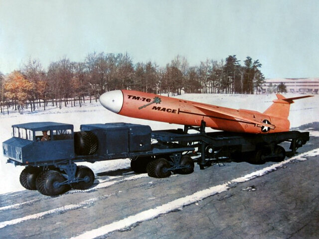

You ve forgotten these
I have several books which feature large numbers of US go anywhere truck designs from the 50s through to the 80s
But it is amusing to note that the old fashioned looking design won in the end.

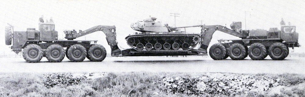

The US post early 1950's has preferred tracked vehicles for off-road tank recovery. To recover tanks they use the M88, based on the later Patton chassis. Once a tank is recovered and brought to a road, a high speed road-worthy truck then tows it to repair or whatnot.The US hasn't had really excellent cross-country wheeled vehicles since the GOER and the Gamma-Goat, both articulated vehicles brought to service in the 70s after long gestations dating to the early 60s. There were the XM800 series articulated armored cars that were interesting and capable but too expensive and maintenance intensive to use in any quantity, so they never saw production. The GOERs are actually ill-suited for driving at speed on improved roads because their lack of suspension leads to unacceptable oscillation. The Gamma-Goats were hearing-damaging due to the engine being directly behind the driver and passenger in the lead vehicle. During the later part of WW2, the US experimented with Superheavy tanks and thus thought they'd need extremely capable vehicles to recover and transport the SH tanks, thus the T26 8x8 as a beefed up 'Dragon wagon'. When the SH tanks were canceled, so was the T26. During the late 40's and 50's the US army still felt the need for very heavy wheeled tractors and started the T57/T58 line of 8x8s, which came to nothing when the army really came to terms with the difficulty of navigating big things like 280mm Atomic Annies through German towns, and not being able to transport them on trains traveling on routes with Bern convention freight profiles. Just too much effort at the end of a long supply chain. The US also never depended on an extensive mobile missile system that required fast and rugged transport like the ZIL and Maz chassis could provide for the Soviets. HEMMTs are nice, but not meant to be driven through mud pits.
