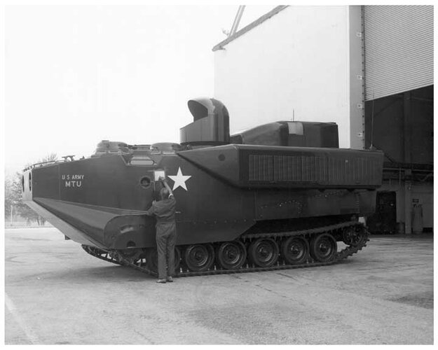

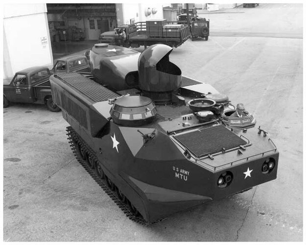

No. The one that took down TOW missiles was this:
