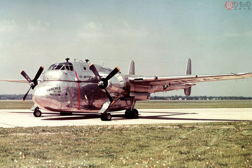

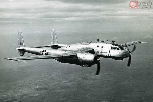

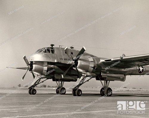

I think that the primary reasons were:
- the unavoidable weight penalty of a detachable pod. Concepts for a production variant IIRC would have reduced this penalty by having the pod attach behind a fixed nose section. This eliminated the need for the awkward forward quadracycle legs and probably reduced the weight of the cargo pod.
- to be really useful, the detachable pods, which would have to be built to airframe standards, would have to be used outside of an airfield environment (like intermodal containers are today), where they would likely be damaged. Modern intermodal containers are constructed of heavy-guage steel and can take a lot of abuse. When damaged, it's not a big deal if they fall apart in transit by truck, ship or railcar.
If the XC-120 had been adopted, I think it might have been especially well suited to:
- rapid conversion between ASW, AEW, tanker, gunship, reconnaissance and transport roles. Maybe even an amphibian.
- dropping massive ordinance
- LAPES-style cargo delivery
You can't have also partial delivery. It's one pod per flight and that's it. You can't for example fly some goods at one point and then equipment to another (unless your pod has a cargo door itself).
