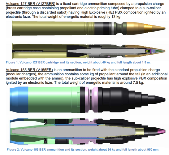

Also WE know how mutch explosive the BER Version for 127 (13kg) and 155mm (7,5kg) have. If we have a diagram about how mutch the guidance takes of Volume we could guess how mutch there is.
  • 22266-paper-Vulcano-IM-test-23-09-2019 (2).pdf
So the 127mm contains more explosive than the 155mm? Must be a longer projectile I guess.
Ah yes, 1.5m long for 127mm vs 0.95m for 155mm, and also 40kg vs 36kg all up respectively.
Yeah. But thats only for BER but i think thats whats needed. Maybe a Future Variant of the 155mm Version If longer (probaly a limitation because of PzH 2k autoloader)

It seems hard to believe. All the 127mm are 66 cm (more or less), a 155mm like the M110/A1/A2 is 68.
The dart seems to extend well back into the body of the cartridge in the case of the 127mm though.

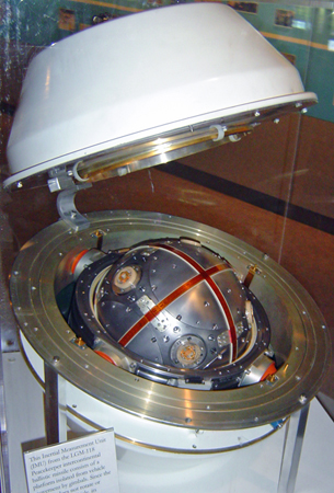

I'm surprised they can make more accurate inertial guidance for these short-range munition these days when you look at the claimed accuracy of AIRS 40 years ago. Sure that was prohibitively expensive, but a short-range munition INS doesn't need anything like that level of accuracy to land within 10m from 100-150km away and then you'll be completely immune to jamming.

AIRS is a fluid-suspended gyrostabilized platform system, as opposed to one using a gimballed gyrostabilized platform. It consists of a beryllium sphere floating in fluid. Jet nozzles are used to stabilize the inertial platform as commanded from the sensors. This design not only eliminates the problem of gimbal lock, but also makes it extremely accurate (drift less than 1.5×10^−5 °/h), to the point that any further improvement would give a negligible benefit to the missile's CEP.
Work that out even for a 30 minute 14,000km flight:
14,000,000 x tan (0.000015/2) = 1.8m
In fact the only reason the LGM-118 had a much larger CEP was because the warheads separated from the bus and were thereafter unguided.
AIRS was prohibitively expensive for regular use, but it must surely be possible nearly 40 years later to design an inertial system that can provide sub-5m accuracy over a 100-150km trip lasting only a few minutes.
