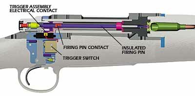

Electrically-fired primers have been a thing on heavy weapons for years, but back around 2005, Remington actually did release a fully electrically-fired rifle called the Remington 700 EtronX. That reduced lock time to the microsecond range (regular rifles are usually 2-8 milliseconds) by completely replacing the firing pin assembly with a non-moving conductive rod. A 9-volt battery in the stock charged up a capacitor connected to the trigger switch, pull the trigger and the capacitor discharges 150 volts down the firing "pin" that's in contact with the primer, firing the rifle. The primers work on heat instead of impact - the priming compound has a conductor (or more properly, I think, a resistor) blended in that heats the mixture to ignition.
Never really caught on, the EtronX cost a good thousand dollars more than a regular 700, they were only offered in .220 Swift, .22-250 and .243 Winchester, and had a "key" that had to be inserted in the grip to fire. The tech worked but there was really no actual market for it at the time, and needing proprietary ammo and/or primers would really limit the appeal then and now (anyone into that level of precision shooting is going to be loading their own).
Voere of Austria also made/make the VEC-91, which pairs the fully electronic trigger with a unique caseless cartridge, but that didn't really go anywhere either.

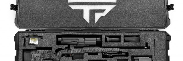

TrackingPoint knows this and fires when the barrel is pointed where the shooter told the computer to hit.

I'm not sure I see the point for an electronic trigger that doesn't include the TrackPoint aiming software. With that setup, you lock the target in the scope and then pull the trigger. Gun goes off when the point of aim lines back up with the locked point of impact, unless you take your finger off the trigger before it goes bang.
I'd forgotten about that thing. Has a ballistic computer in the sight:
