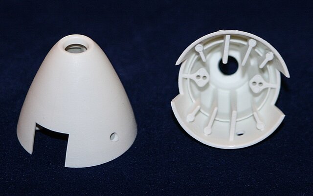

Many electrically powered, small UAS use spinners that provide cooling air to the motors. Does this qualify as entering production?

I guess with fixed pitch propellers such spinners/hubs can be more effective, do these UAS have a variable pitch?
No - fixed pitch. Obviously, there's a nicely radiused hole in the nose and then moulded inside are vanes that work as a centrifugal fan. Holes in the motor mounting face then allow this air flow to cool the motor. Also these won't work without some sort of hot air exhaust ...but that's another topic ;) Example picture attached
