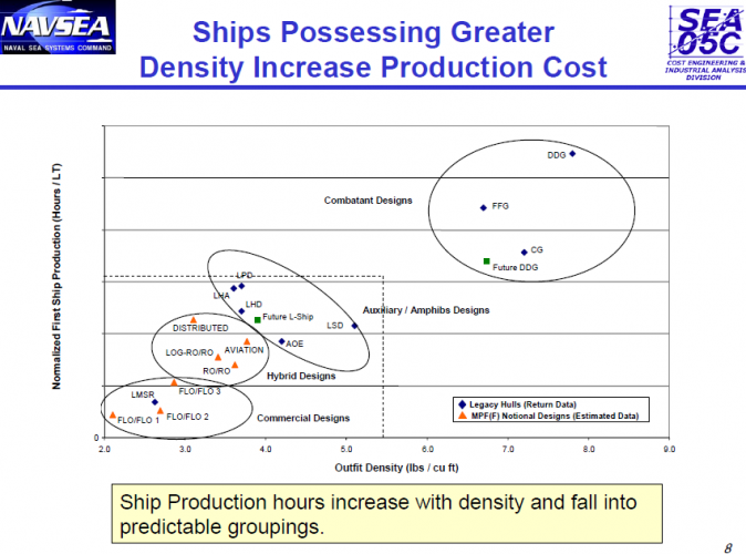

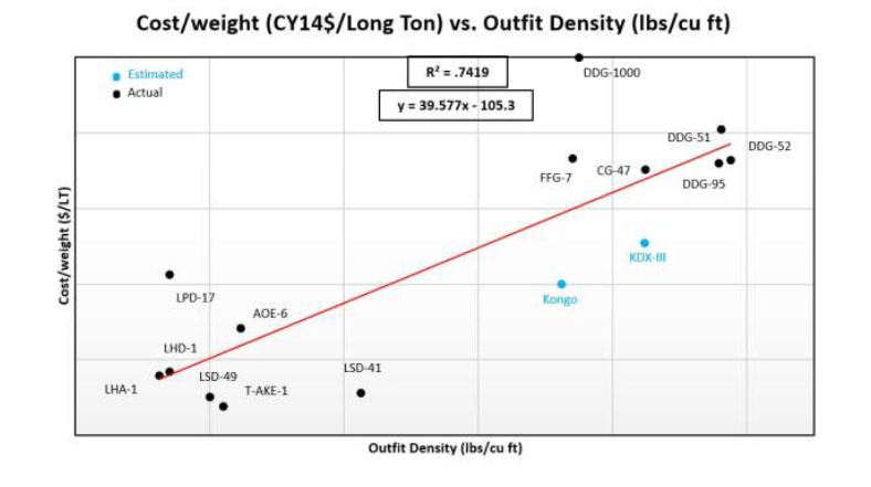

Who wants to take bets on the cost journey of the ship?
Ah, surely Zumwalt’s prolonged construction can’t be traced to anything else besides the IEP plant.why would you ever think of using the IEP Zumwalt hull as basis of the DDG(X)
Burkes are currently like $3b per hull, so I really doubt it comes out as under $5b. Even $5b seems like an obviously way too low estimate.I’m guessing $3.5-5B for a single hull using FY25 dollars. *Cost assuming a 1 hull order
And once again, may I remind you that the Navy doesn’t think IEP will meet its power demands?
How come?Even $5b seems like an obviously way too low estimate.
Zumwalt is an awful comparison for the DDG(X) program.GAO quotes Zumwalt procurement as $17.25 billion for the 3 ships and $14.6 billion in
development, total progam cost $31.8 billion, $10.6 billion per ship - FY 25 dollars.
So like $3bA CBO report from January 2025 estimated that the average cost of a Flt III Burke (assuming 61 total ships purchased) would be $2.7B per hull in 2024 dollars
Is that for a multi-ship buy, or a single hull/year?A CBO report from January 2025 estimated that the average cost of a Flt III Burke (assuming 61 total ships purchased) would be $2.7B per hull in 2024 dollars
Sorry, I meant 23 ships ordered. The Navy is ordering these ships in multi-ship purchases, and the production rate is about 2 per year (or just over?). But the Navy's plan is to overlap DDG-51 purchases with DDG(X) purchases from 2032 to 2037. 13 DDG-51s will be ordered by 2028, leaving 10 ships to order between 2029 and 2037, according to the plan. In reality, who knows how this schedule will actually go. My guess is that the DDG(X) will be delayed and more DDG-51 ships will be ordered until DDG(X) is ready to take those production slots. Hopefully the yards are kept working at a consistent pace with no dropoff in destroyer production between DDG-51 and DDG(X).Is that for a multi-ship buy, or a single hull/year?
