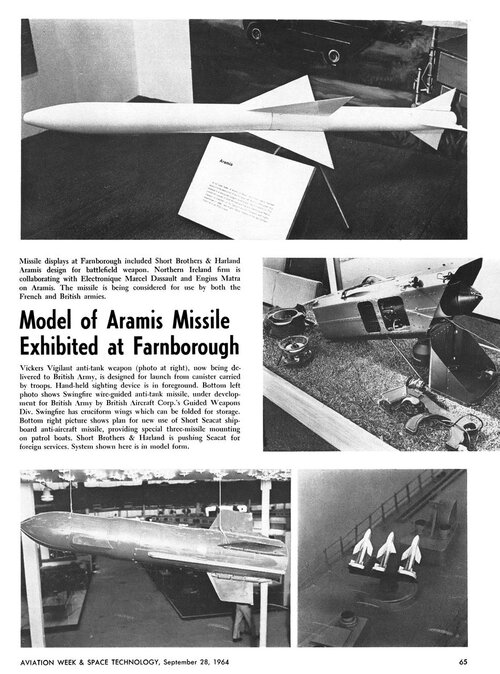

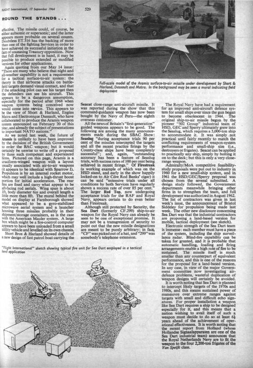

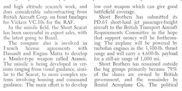

Rapier / Mauler class SAM proposed in 1964, reportedly with a range of guidance options from Seacat-style visual to more sophisticated means including microwave radar. Three-round trailer-based launcher and separate fire-control trailer.
Flight estimated size about 8ft long, span 1ft, diameter 6in based on model at 1964 Farnborough show.
Shorts announcement on 20 February 1964:
"A presentation of the proposed system has been given to the Ministry of Aviation and representatives of the Service departments. Presentations will follow in France and other NATO nations."
No further mention in AvWeek or Flight after late 1964. Name later recycled by Bodenseewerk for a 1996-era ramjet-powered ARM.

Interesting, I wonder how much of Seacat 2 was carried over into Aramis given that this appeared only three years later. Certainly the main and tail fins look quite different.
It's also interesting to compare the approx sizes (as estimated by the aviation press from the models on display) in inches:
Aramis - span 12in, length 96+in
Seacat 2 - span 20in, length 78in
Seacat 1 - span 26in, length 58in
