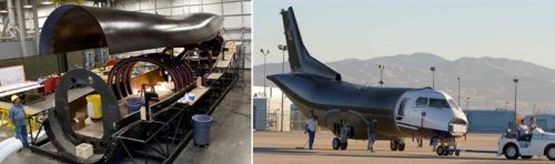

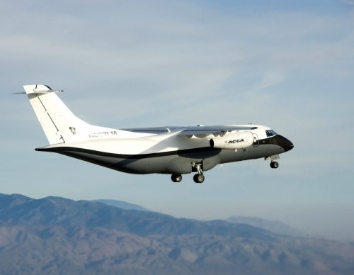

See this, just released by LockMart:
Lockheed Martin Awarded Phase II Advanced Composite Cargo Aircraft Flight Demonstration Contract
PALMDALE, Calif., October 17, 2007 – The United States Air Force Research Laboratory (AFRL) has authorized Lockheed Martin [NYSE: LMT] to proceed to Phase II of the Advanced Composite Cargo Aircraft (ACCA) Flight Demonstration contract.
“This contract represents an important first step to advance composite usage on next-generation tactical air mobility transports,” said Frank Cappuccio, executive vice president and general manager, Advanced Development Programs (the Skunk Works®), Lockheed Martin.
Under the contract, Lockheed Martin will build and flight-demonstrate an X-Plane type aircraft with emphasis on innovative structural configurations and concepts to include advanced prototyping and composite technologies. Its solution involves replacement of the mid/aft fuselage and empennage of a Dornier 328J aircraft with advanced composites within the required 12-month schedule.
“With ACCA we are attempting to reinvent the manufacturing paradigm through the strategic use of composite manufacturing technologies,” said Frank Mauro, vice president, Advanced Systems Development, Advanced Development Programs (the Skunk Works®), Lockheed Martin. “This is an important opportunity to forever change the way composites are used in aircraft manufacturing, leading to lighter, less expensive, more durable aircraft that are easier to maintain.”
Lockheed Martin’s integration of advanced composites on the ACCA flight demonstrator will enable a reduction of 80-90 percent in parts count and a dramatic reduction in corrosion and fatigue issues compared to conventional aircraft manufacturing approaches. Planned growth provisions will allow it to be used well into the future as a technology workhorse for additional air mobility advanced transport experiments. Further, ACCA will provide production traceability allowing the key technologies to be applicable to a broad spectrum of next generation aircraft including long range strike, unmanned systems and future air mobility transports.
ACCA is a capstone demonstration of several technologies developed under recent Department of Defense Contracted Research and Development (CRAD) programs, particularly the Composite Affordability Initiative. “AFRL is excited to authorize Lockheed Martin’s Skunk Works® to proceed with their highly innovative demonstration program,” said Barth Shenk, AFRL program manager. AFRL is currently investigating opportunities for Aurora Flight Sciences to collaborate with Lockheed Martin and AFRL in the demonstration of additional technologies and capabilities for future transport structures.
This is not the first time. Siskorsky built their first all-composite helicopter using the S-76 as a pattern.
You can see what the ACCA X-plane looks like here:
http://www.flightglobal.com/articles/2007/10/17/218714/lockheed-martin-to-build-composite-airlifter-x-plane.html

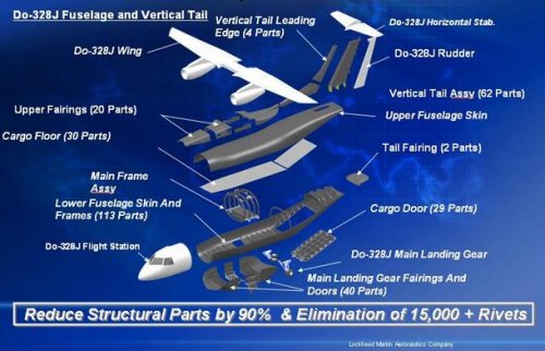

The fuselage aft of the flightdeck is replaced with an advanced composite structure that is wider, to accomodate two 463L pallets, and has a rear loading ramp. The vertical tail is replaced, but the wing and tailplane are retained.
Because AFRL did not have the time or money for an all-new demonstrator, the Skunk Works looked at a range of existing aircraft and picked the 328Jet because of its size, speed and the fact it was relatively modern, so design data was still available.
LockMart says it has proposed a roadmap to morph the ACCA into a demonstrator for other AJACS technologies, which I assume could mean integrated propulsion, lift and control with embedded engines. It all depends on funding, or course.

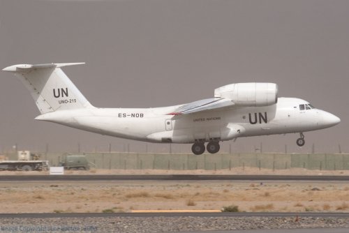

Greysleuth said:
Got this today from someone in the air cargo business
Hi there,
As for the An-72/74, I don't know which one that might have been. None have
adopted an N-reg, as far as I know, but several have been across the pond
for various experimental projects. There was one required by Aurora Flight
Sciences for a few weeks in Manassas, Virginia in May of this year, and we
offered them an Enimex example. No idea what they wanted it for. They
delayed in replying for a week or so, and then did the deal with Enimex
direct, cutting me out ! I was mightily pissed off again!
What do we know about Aurora Flight Sciences?
Your comment, suggestions and observations much appreciated.
Thanks for your input so far.
Be lucky
David

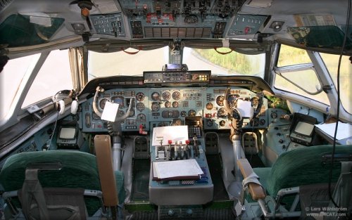

My apologies to the pissed off gentleman. We did get an An-72 (ES-NOB, there's a picture of it on Yefim Gordon's "Antonov's twin jets", p121), and at the time it was painted white but we could barely read "UN" (as in united nations) written in big black letters on the tail. We played with it for a month. It was parked in our hangar and I could see it just looking outside my office. That plane was awesome. Rustic, but awesome. Lots of neat solutions, like the way the cargo ramp can slide under the fuselage, blreds into the tail, or the thrust reverser system to name a few. I can talk about this because the An-72 is on our company calendar. We lost the main award for ACCA to Lockmart's 328, a much smaller aircraft. :-[
Gents M-O-N-E-Y. Plain and simple. Best looses to cost in a heartbeat, especially on experimental efforts. An-72 would have been a superb demonstrator. Sadly I suspect the USAF probably had a bit of prejudice regarding a Russian aircraft. Speculation on my part.
Lol ;D
That's ES-NOB alright, the baby we kept for a month!
I think the plan was to keep the An-72 secret for a while, but the whole thing was too big to fit in our hangar and the tail was sticking out; not much secrecy there i'm afraid. ;D

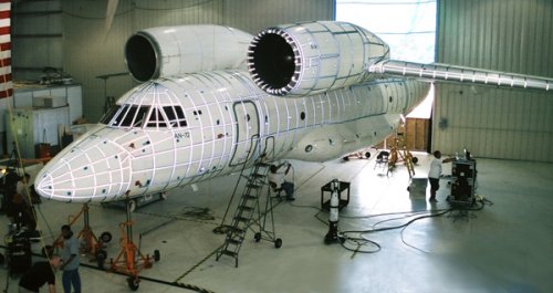

since this appeared in our company calendar, i think it's kosher to post...
I liked having Cheburashka in our hangar...

Another view...
So if someone can answer this question, why did they cut up and rebuild a Do-328 instead of just build a new plane, since that's almost what they did anyway?
Most likely to save time and money. To design and build a completely new airplane to evaluate advanced composite material would have taken much more time. Even for the Skunk Works. Besides, maybe things are slow within the Skunk Works and LM wanted to keep its engineer and employee base active.
If you are to demonstrate a new technology, better use a proven airframe, because if you don't, then you have to add up the aircraft's own test program on top of that technology's test program, and that more than doubles the whole evaluation period. Using proven elements gains time (Hiller's X-18 used a Chase C-122 airframe, Grumman's X-29 used a Northrop F-5 airframe) and of course saves money. The two programs described above (and many more) were successful. Others that introduced a new airframe were troubled with lots of technical obstacles to overcome (X-19 for instance).
Lockheed Martin illustration showing X-55 ACCA components.
Source: Norris, Guy "X-Plane Updated" Ares blog at Aviation Week & Space Technology.
http://www.aviationweek.com/aw/blogs/defense/index.jsp?plckController=Blog&plckScript=blogScript&plckElementId=blogDest&plckBlogPage=BlogViewPost&plckPostId=Blog%3A27ec4a53-dcc8-42d0-bd3a-01329aef79a7Post%3A628ff5ca-e739-4546-b2ee-7e715e1c51cf
