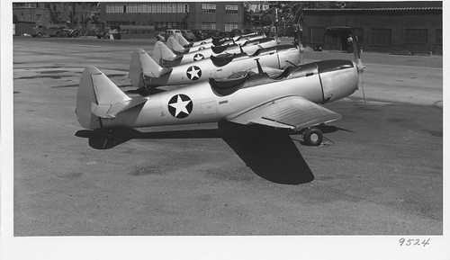

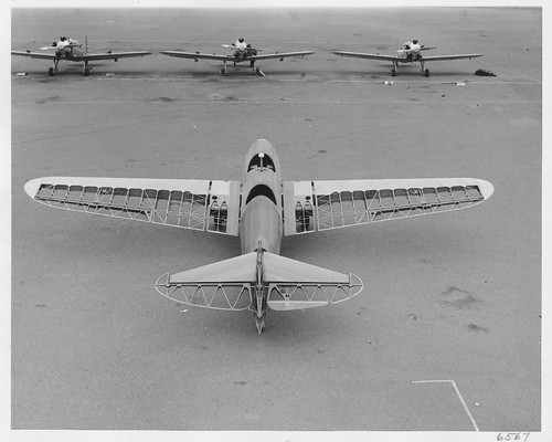

I'd also add the Ryan PT-25 (YPT-25) to the list, built of bonded plywood. Only five were built.
Some great photos (again) at the San Diego Air & Space Museum's Flickr Commons archive:
http://www.flickr.com/photos/sdasmarchives/tags/ryanpt25/
http://www.flickr.com/photos/sdasmarchives/5684489903/
http://www.flickr.com/photos/sdasmarchives/5684488907/

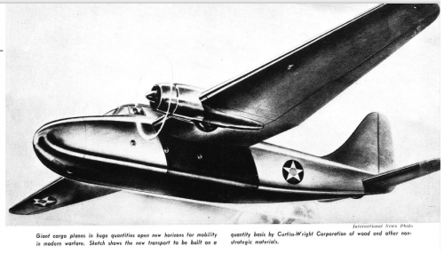

please help,I found this artist drawing to a giant cargo aircraft,maybe a Project,they said it was going to
build in Curtiss-Wright company,I don't know if it was from its design,or its a real aircraft from anther
firm,built under licence or what ?.

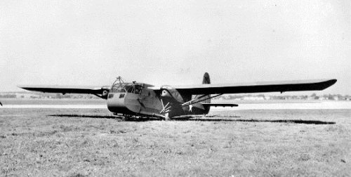

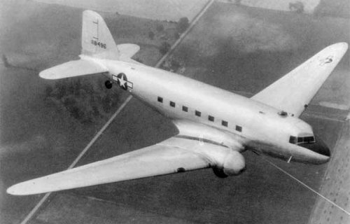

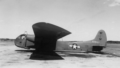

Projects to motorize the WACO CG-4 (known as the PG-2, I'm guessing PG stood for "powered glider") should also be on the list, Interestingly, and an initiative in the opposite direction, the XCG-17 - an unpowered version of the C-47 was also tested.
