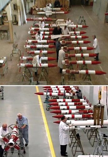

The below picture shows the production line of R-77 which was taken in 2007.
That makes no sense. Why would they have a stage of production where the grid fins are installed that close to the nose of the missile? :confused:

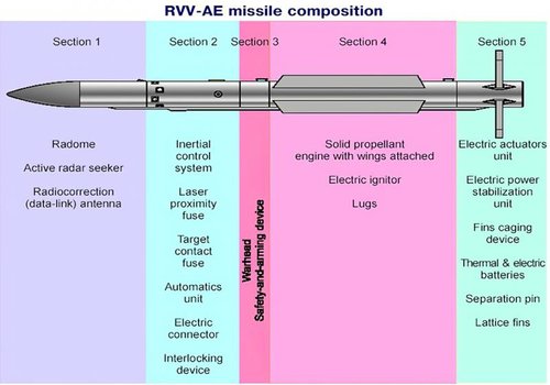

"...However, upon close examination, it is apparent that these are selected sections of the regular RVV-AE missile assembled together, including the seeker, laser proximity fuse section, control system compartment and folding lattice fins. The weapon lacked the central section of the body—including rocket motor and wings—as well as, possibly, the warhead. It is most likely that the missile on display is from a stage in the standard RVV-AE production cycle.
This supposition is strongly supported by how similar “short” missiles can be seen in much older illustrations. Weapons of that type were shown in a large number on the Vympel production line in a 2007 movie marking the company’s anniversary . At that time, Russia had not yet dreamed of internally carried air-to-air missiles. ..."
