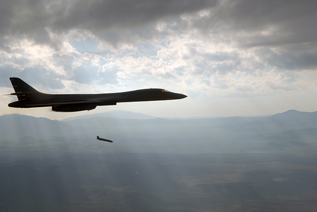

Said bombs (SDB) can be released from 50 nautical miles from the target at altitude. That puts you well outside the published envelopes for a lot of air defenses -- or at least the cheap to medium grade kind. You're still at risk from super deluxe air defenses (S-300 latest version); but there aren't that many of those floating around...
bobbymike
Apr 21, 2009
11,346
2,946
And those sites will probably been seriously degraded when the first few hundred MALDs, JASSM and JASSM-ERs target them.
