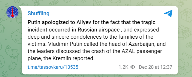

Lame. He's not even owning up to any Russian responsibility whatsoever. Not unexpected of course, but still lame.

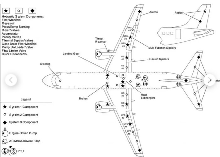

During the flight over Grozny, data recovered from the black box recorded a sonic boom, followed by an alert indicating the shutdown of the autopilot and automatic regulator. This led to a failure of the aircraft’s primary control system.
“Hydraulic System 3 pressure dropped to zero, and its fluid level decreased to 0%. The flight control surfaces became locked in a neutral position and remained in that state until the crash. A trim system failure was detected. Cabin depressurization occurred, triggering an emergency alarm. Hydraulic System 1 pressure dropped to zero, and its fluid level also fell to 0%,” the report states.
The witnesses, including injured passengers, and surviving flight attendants reported hearing explosion sounds over Grozny, with one flight attendant sustaining arm injuries and another passenger wounded in the arm and leg. Russian nationals on board also corroborated hearing three explosions and reported that the sound appeared to originate externally, followed by impacts on the aircraft.
No ailerons. No rudder. Partial elevator. They did it all with engines and flaps, presumably.
