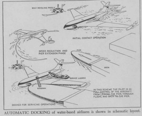

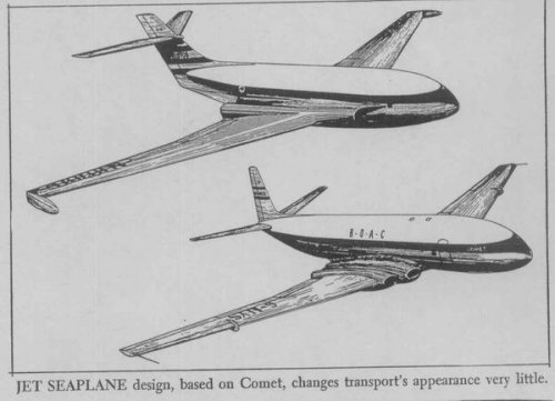

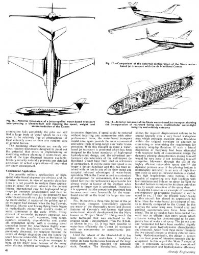

Convair considered a flying boat derivative of the Comet !
From AviationWeek 1/54)
Wow a flying boat Comet is new for me!
But, this air inteakes aren't very low to prevent water ingestion? ???

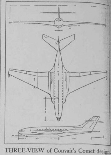

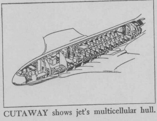

I can just add a 3-view from the mentioned article, but there aren't specific informations
about this project, because the article just deals with the chances and economics of
flying boat operations in general. No problem to mail this article to anybody, who's
interested, but don't expect much technical data.

It seems, it wasn't a look alike, but really a modification, but there's no
further information, sorry. I've attached the inmternal layout. Interesting,
I think, is, that the seats are facing backwards, as in the british military
transports.

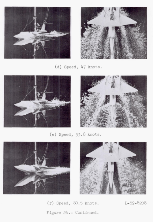

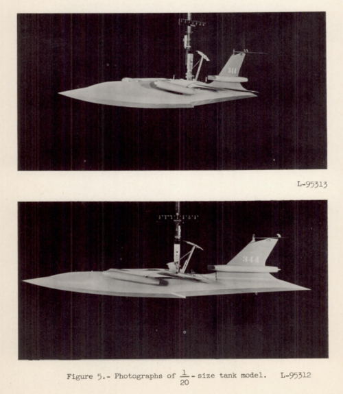

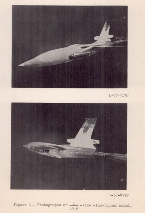

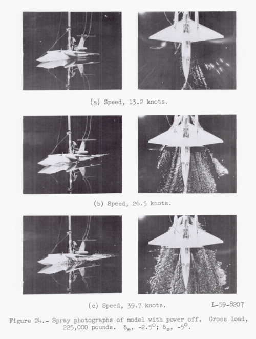

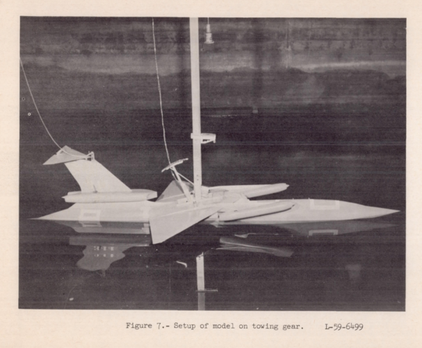

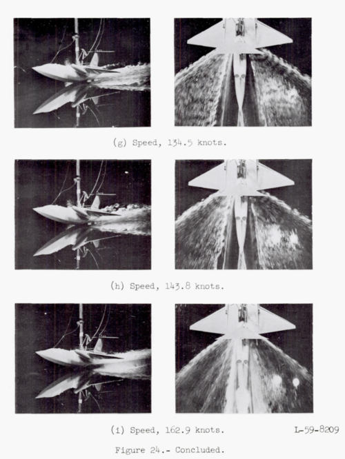

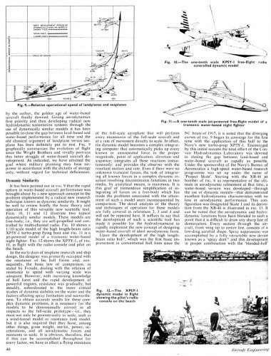

I don't know if this has been shared before, but it seems like it belongs in this topic: NACA Tank Model No. 344.

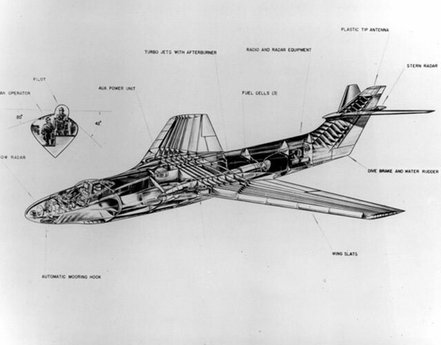

This model, by its size and number of engines, rather reminds me to something like the Convair Water Based B-58 (Sea B-58) , or the NASA TM X-191 ( see Scott's US Supersonic Bomber Projects Vol.2), sizeable bomber projects. ;)
ARDC Seaplane Study (1957) ?
Convair Advanced Designs Vol 1 (Robert E Bradley) pg 107
