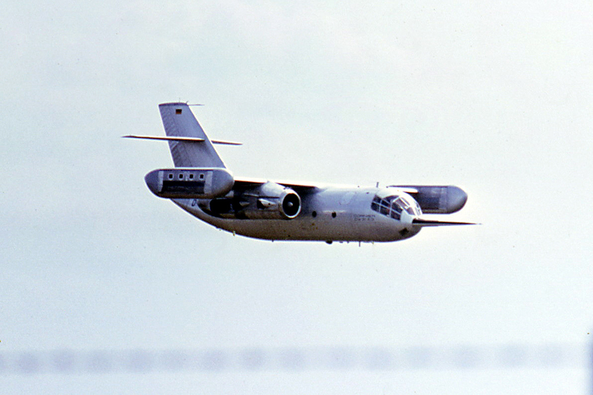

The only thing i know close to a Harrier is the Do-31.
A single engined Harrier-like civil aircraft would be very expensive and very "unsafe" because if the cabin was above the engine the center of gravity would be at a very strange place causing stanility problems etc.

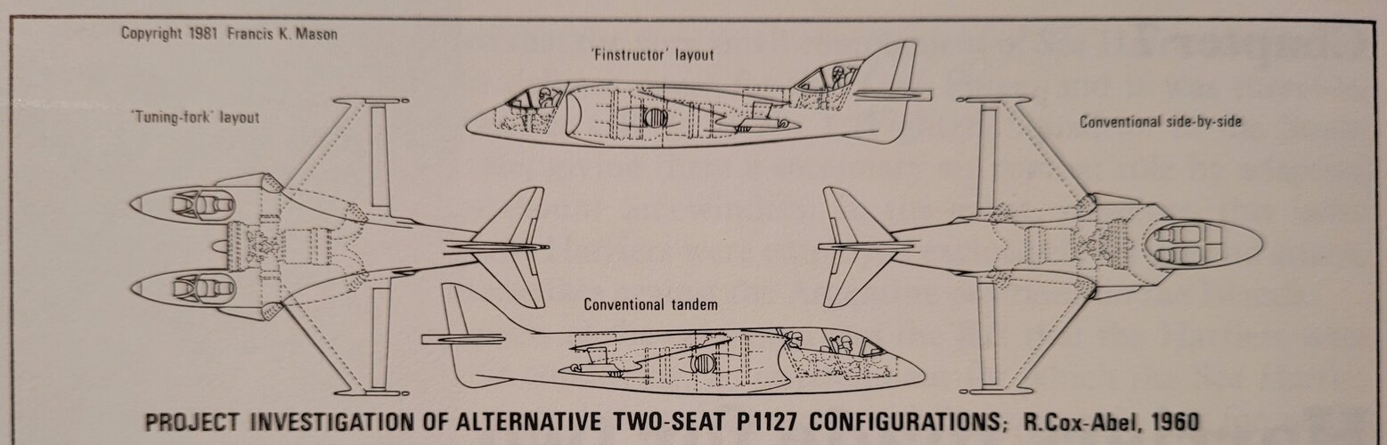

Something like the DuPont DP-2 could have been the result.
But a passenger cabin wouldn't necessarily have been above the
engine. We just have to remember the first layouts for a two-seater
version of the Harrier . :D
(from F.K.Mason "Harrier", sorry for the bad quality, the scan was done
a long time ago with my very first scanner)

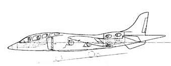

The Mason book also shows a version with a second cockpit at the base of the fin. This was reprised in the mid 1970's for the HS.1199 project, in which a 5 seat 'personnel transport' Harrier was looked at. This project was looked at in relation to concerns of terrorist hijackings of North Sea oil rigs - how to get a special forces squad out there ASAP?
Attempts to put all the extra people in a modified front fuselage (in tandem pairs behind the pilot) raised balance issues, so there was an idea of putting a couple of people in the tail/equipment bay. Picture of this attached. Anyone who knows about the rear fuselage vibration issues on the Harrier would realise this was a non-starter - any budding James Bond type sitting there would soon be severely shaken, if not stirred.
Of course, there was a 'civil' Harrier, G-VTOL, Hawker Siddeley's Mk.52 demonstrator. That is as close as sense would allow a civil Harrier to get.

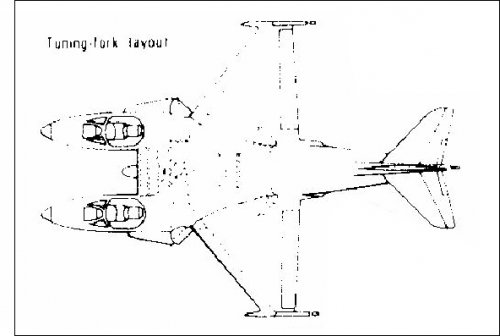

Does anyone know of a side elevation drawing of R. Cox-Abel's 1960 'tuning fork' P.1127 study ? I'm only aware of the plan view in FK. Mason's Harrier book
Cheers, Joe
