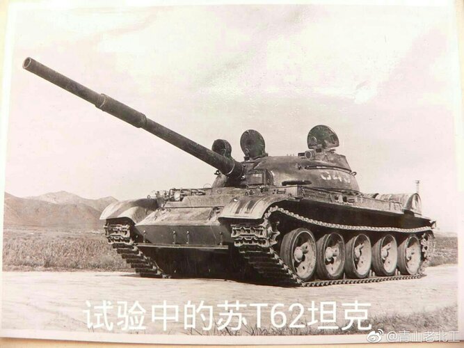

The story began in 1969 in the Sino-Soviet border conflict,Chinese captured a T-62,At that time, all their anti-tank weapons were unable to effectively destroy the T62.

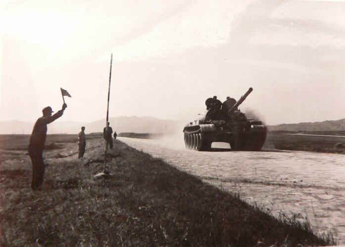

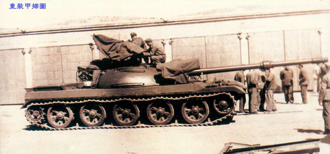

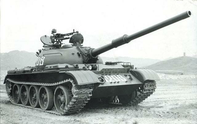

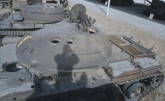

T62 under test
In December 1969,,Armored Forces and Design Department Meeting in Beijing,The meeting discussed the design work of the second-generation tank and the choice of main gun caliber
There were three options for the caliber of the main gun at that time, 100 mm (may be a type-69 smoothbore gun), 115 mm (may be a copy of the T-62 main gun), and the final choice 120 mm smoothbore gun

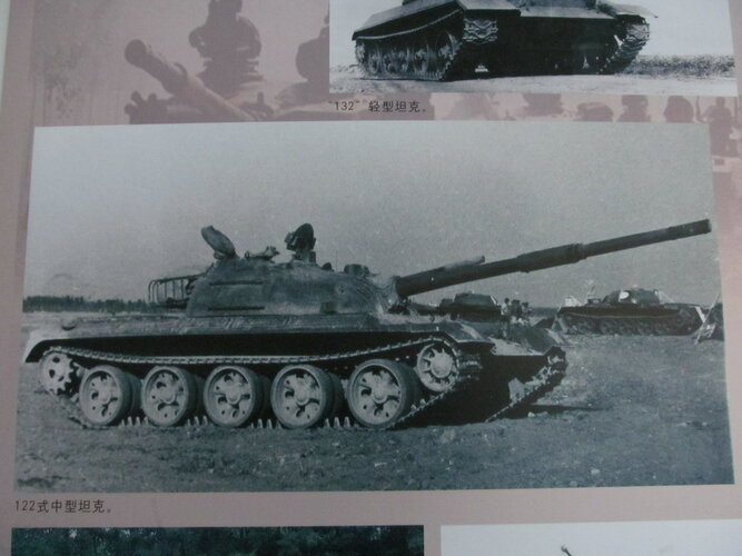

In the fall of 1970, the construction of the 122 three-hydro was completed(Hydro-pneumatic suspension,Hydraulic transmission,Hydraulic assisted control)at 617 factory
But the test proved that the new hydraulic technology is not reliable enough,So the original Hydro-pneumatic suspension was replaced by the traditional torsion bar suspension,
This is the 122 three-mechanical

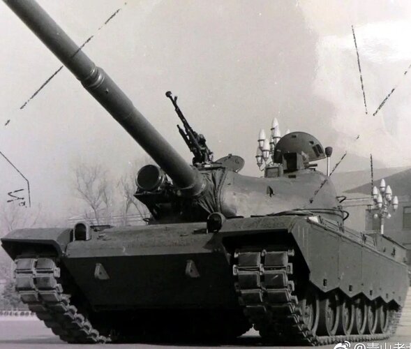

122 three-hydro,the Hydro-pneumatic suspension is completely relaxed
The most famous photo of 122 three-hydro

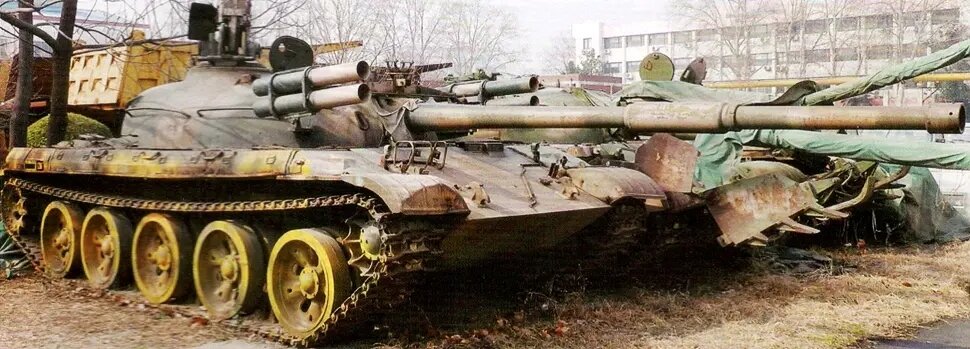

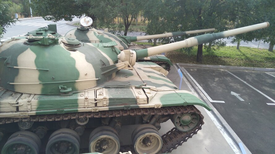

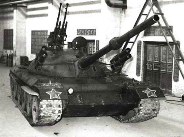

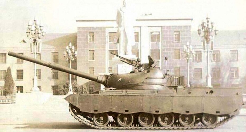

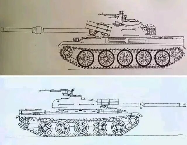

122 three-mechanical,The anti-tank missiles were removed, and the twin 12.7 mm machine guns were replaced with a single one, fume extractor has also been changed
At the same time, the prototype built at Luoyang's 704 factory,The main gun is similar to the 122 three-mechanical, but has a muzzle brake
Anti-tank missiles are retained,12.7mm machine gun replaced by 20mm gun
122 three-hydro and prototype 704

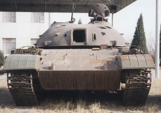

122 three-hydro Probably disassembled,and The main gun was later installed on the 1224

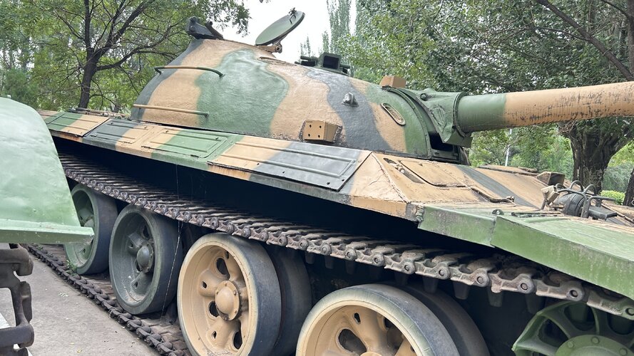

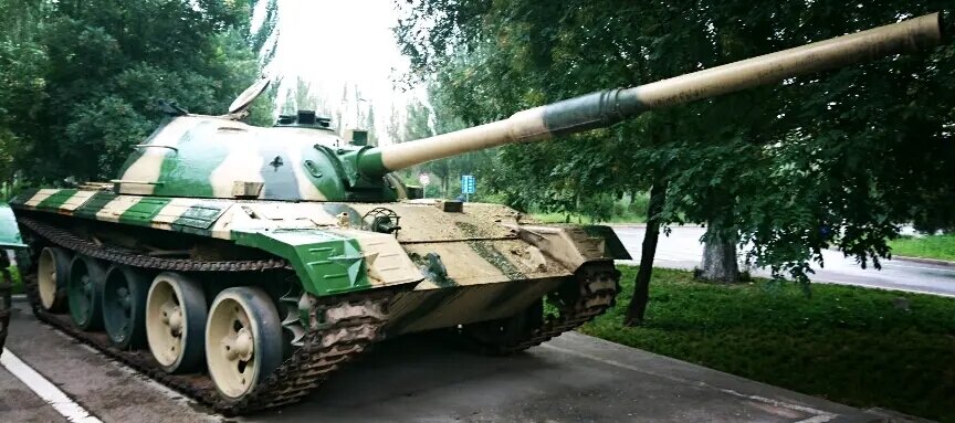

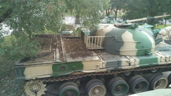

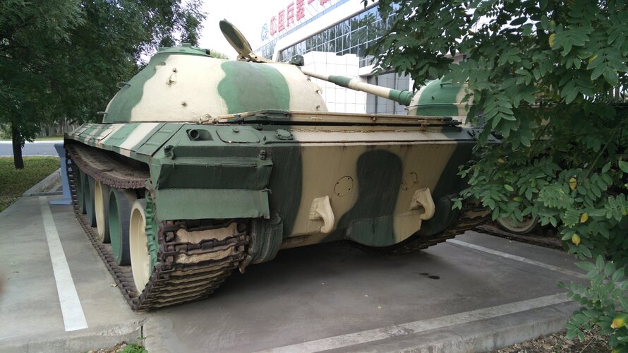

but 122 three-mechanical(Probably more than one,There is a strange tank in the Chinese Tank Museum, which is very similar to a 122 three-mechanical turret on type-80 hull) and prototype 704 all survived

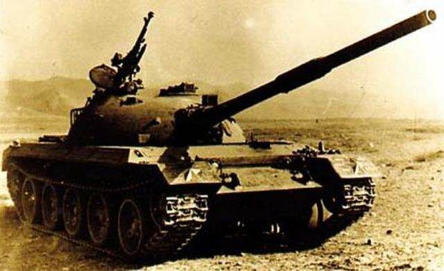

122 three-mechanical in 617 factory
For 122 three-mechanical,everything is fine,Hope to serve in a few years

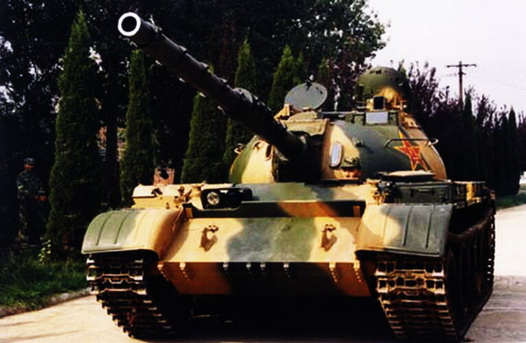

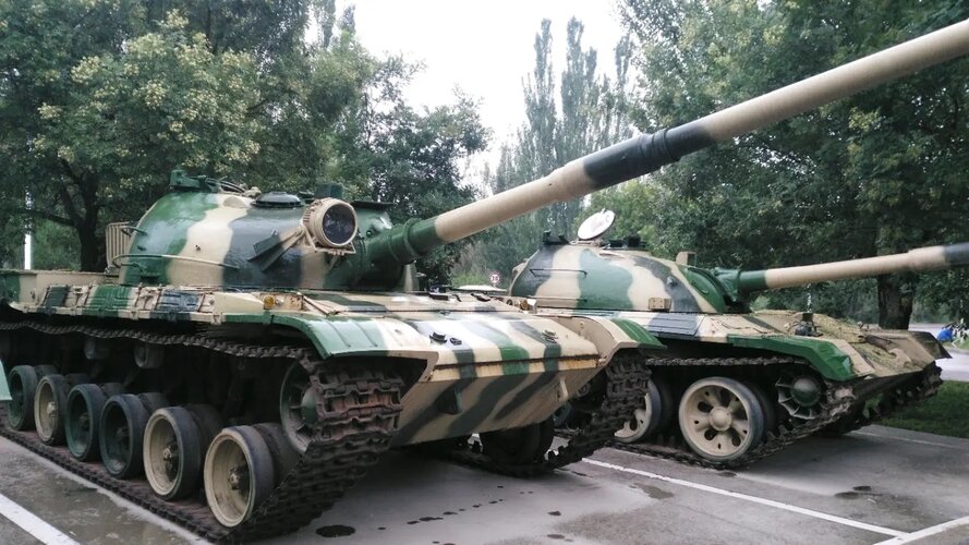

The 1223 is based on the Type 69 tank, but the entire car body has been rebuilt, the car body has been lengthened, 6 pairs of road wheels, replaced with a 730 horsepower engine, and most importantly, the L7(In fact, there are not many original L7s in the Chinese army. Most of the 105mm artillery is actually a mixture of L7 and D10T.)
There are several other types of Chinese tanks with L7 installed at the same time.
120B(type59-2)
type69-3(renamed type79)
Ditto to ^, gave an ex tanker some thought provoking reading.
1223 finally won the game and received the number WZ122(better known as type80/88)

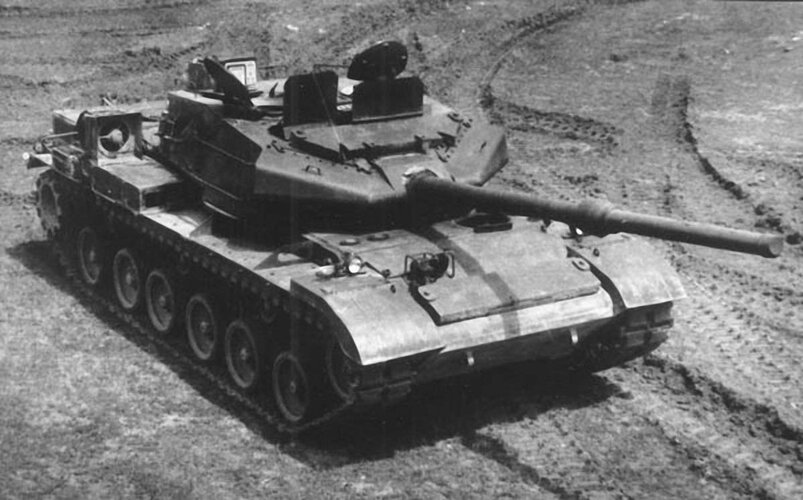

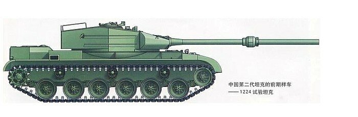

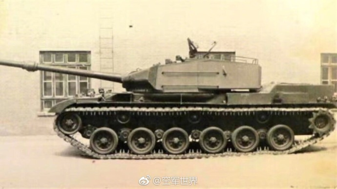

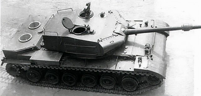

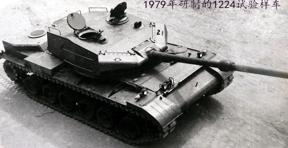

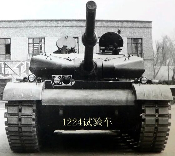

In March 1979, the 1224 prototype was completed,According to the requirements of the Army, the design target of this tank is a Chinese version of Leopard II. A 45-ton tank with autoloader,composite armor, new 120mm smoothbore gun, high-power diesel engine(The prototype used MB8V331TC41),advanced fire control system·····

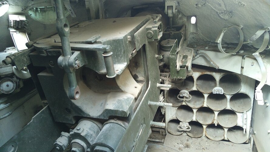

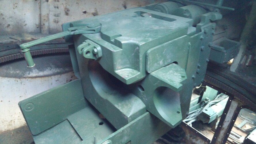

Autoloader

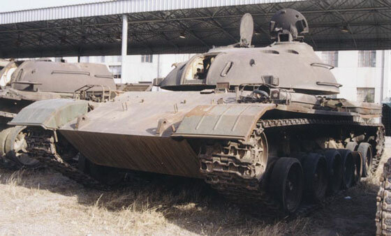

1224 photos in different directions

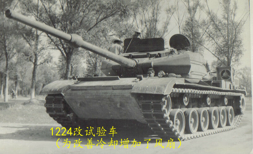

The improved 1224 in the test added a temporary cooling fan, and a counterweight used to simulate composite armor was added to the upper part of the turret and hull.
The reason for giving up 1224 is unknown,Most of the relevant Chinese materials only say that this tank has completed its work
First of all, it’s not artillery, because the successor 1226 still uses 120mm gun.
Second, it’s not the engine, also because the 1226 uses a 1000-horsepower diesel engine
Third, maybe it’s an armor problem. 1224 has only counterweights and no actual composite armor, but 1223 doesn’t have it either.
In short, at the end of 1979, the job of 1224 ended,But in 1985, this tank was modified to be used as engine test and renamed BK1850,
The condition of this tank is unknown, but it should not have been disassembled because there are some related photos
Autoloader
Top view, to me looks like a british tank, maybe a bit of conqueror going on? And lower the wheels and tracks very M48/M60 ish.
But very interesting, as I'd always assumed china just build T55 etc.
I read on the Sturgeon's House Chinese vehicle thread that the engine powering 1224 and eventually Type 98/99 was actually a CV12 or at least based on it/using technology from it, is their any truth to this?
There seems to be a lot of Centurion in that, engine decks similar to the Israeli variants and M48/M60.

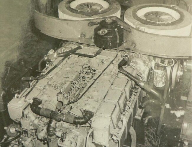

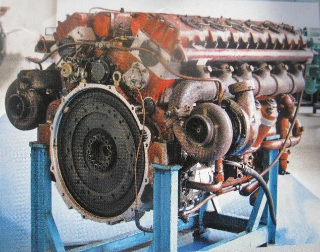

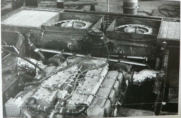

The 1224 has only one prototype, using a German engine,1226 has two prototype with different engine,1226 used 8V165,1226F2 used 12150 improved(12150 is Chinese built V-2)
type 99 used 150HB,The relationship between these engines is not very clear
1226 engine
it looks much more like a centarion while the track and wheels are from m48 patton.Maybe the Pakistanis donated some m48 to him For centarion via Syria or Egypt although I think the Chinese bought centarion from Israel for testing

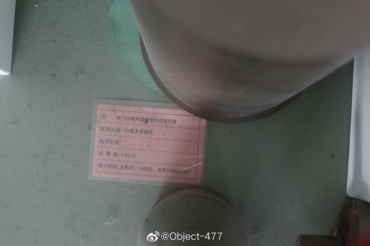

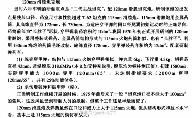

A simple translation

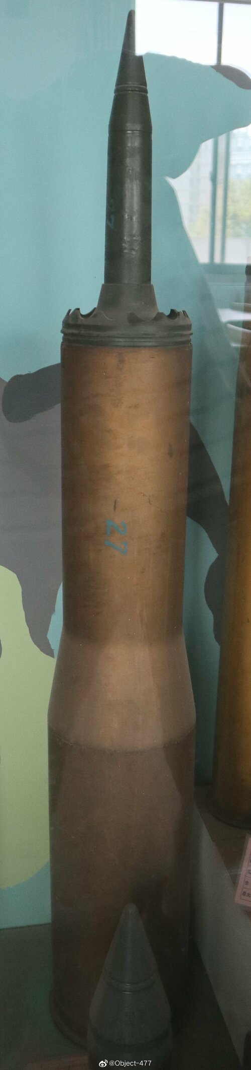

120mm smoothbore gun, designed to surpass the T-62's 115mm smoothbore gun,
The round is similar to 115 mm smoothbore round,The cartridge is based on the Navy's 130 mm naval gun cartridge
APDSFS round weighs 6 kg( projectile 4.3kg,diameter 43 mm)Penetrates 120 mm of 65-degree angled armor at a distance of 1000 meters
HEAT and HE has no details
In 1975, because the leadership requirements change ,The project was terminated.
Although the 120mm smoothbore gun has improved performance, it is basically an imitation of the 115mm smoothbore gun

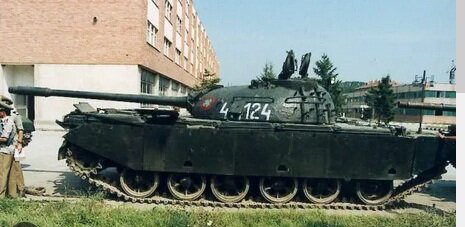

these tanks are very similar to the Romanian tr 580 Perhaps the Romanians or the two countries cooperated in the development of their tanks how now?
romanian tr 580
romanian tr 580
I wouldn't be surprised if there was some indirect help from Romania considering Ceausescu was quite friendly to China and they sold a few T-72s under the name of Type 64. I don't have any concrete info about the 122 projects and Romania though.
