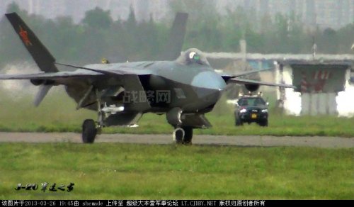

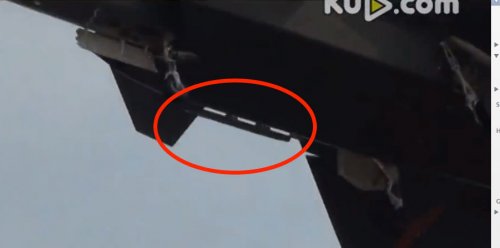

Is it just me, or is it landing with its weapons bay door partly open in that video?
As shown up-thread, that's the lunch-rail not the doors. The launch rail can stay extended when the doors are closed. Read up thread and look at the diagrams provided to see how they are going about that.
Sundog said:
D'oh, got it now...

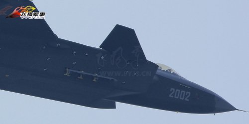

Deino said:
It's definitely a more efficient use of space than the current F-22 side bays. On the other hand, with a little work, I'll bet they could get two AIM-9Xs in each of the F-22s side bays.

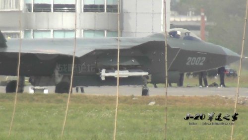

... still not sure but at the CDF they take this as a confirmation for the PL-10 !

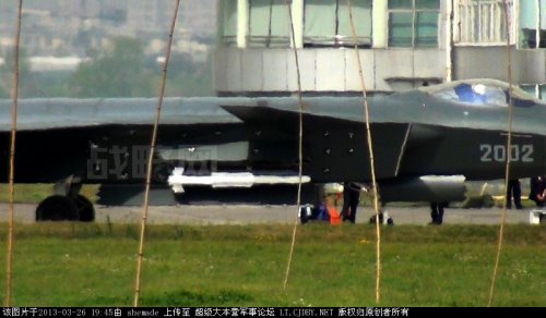

Err Deino
What can we see in white on the inside of the belly weapons bay door ?
Even if not fully confirmed it seems that this is the PL-10 IR-guided SR-AAM.
Geoff_B said:
Err Deino
Just an edge of second section of the weapon bay door.

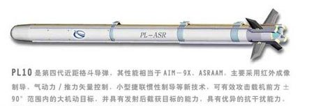

No, the Aspide-copy is the PL-11 ... PL-10 - once called PL-ASR - is the new SR-IR-AAM and long expected to be similar to (or even based on) the South African A-Darter.

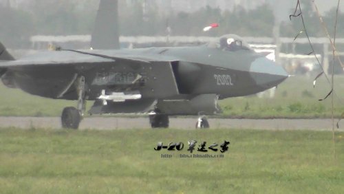

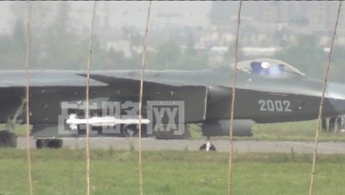

The missile in the photograph seems to have butterfly wing shaped tail fins similar to R-27 alamo's central fins, also it seem larger than typical short range AAM.
What are those dots on the fuselage surface all around the missile bay? Camera reference markers?
Possibly, but the level of distortion in the photo makes it hard to be sure. It may just be untapered.
As to size - maybe, I will do some scaling calculations tonight.

I can't decide if the fins have reverse taper, or maybe have some curvature like the wrap-around fins on the BGM-110 cruise missile.
index.php
Here's a poor quality copy of the PL-10 picture from a 2010 AAM development roadmap of uncertain provenance. Added wings to the earlier A-Darter style layout, but tail is different from the missile on the J-20. If they are actually reverse taper, it may be to get greater control authority as it was on R-27 - with the cost of increased drag when used.
PaulMM (Overscan) said:
Size appears to be roughly 2.9m length, depending on your idea of how big J-20 is.
What could fit - and even more that wide diameter - to my theory that the PL-10 we saw above (and as shown in my book ??? ) was abandoned and replaced by a PL-8/9-based design with new control fins, TVC and so on.
