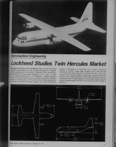

Another view and a 3-view here from Aviation Week 1977 1-9 :

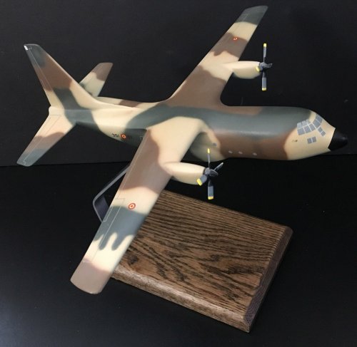

DonaldM said:
Is this legitimate or the work of Asian craftspeople?

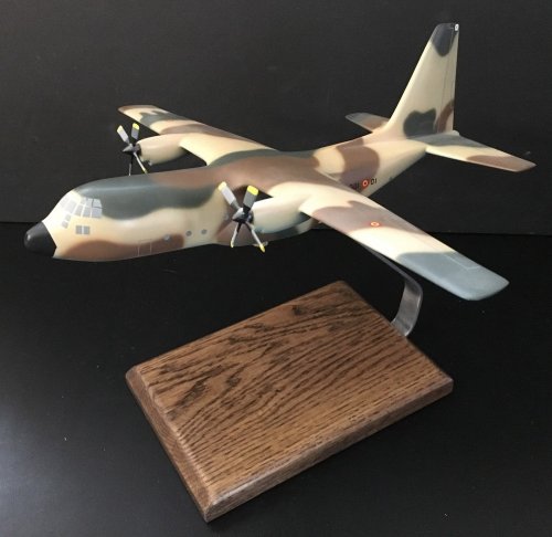

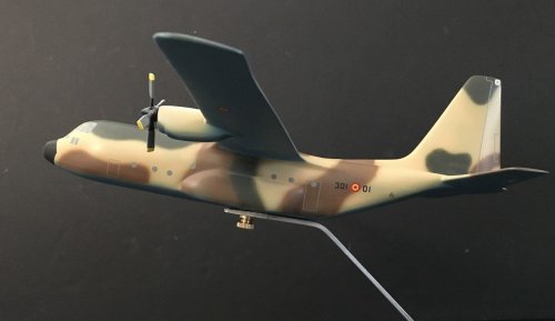

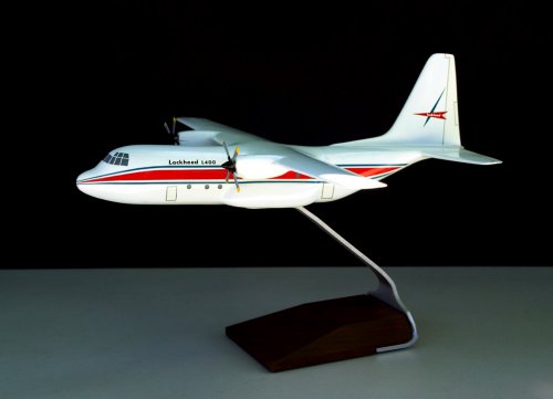

This is a "real", vintage model. Pacific Miniatures (Alhambra, CA) made a number of these L-400s for Lockheed, when GALAC was trying to market the design. I've seen these models mostly in house colors. I also have one is U.S. Navy finish, but this is the first time I see an export version (Spain). The stand is probably not original.
DonaldM said:
Were the L-400 models made of wood?
No, these were resin castings. I estimate Pacific Miniatures stopped using wood around 1960.

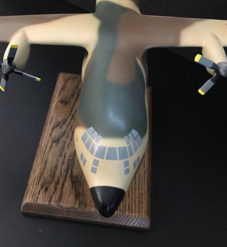

Also, sorry about the thumbnail -- attached is the photo I meant to post.

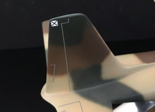

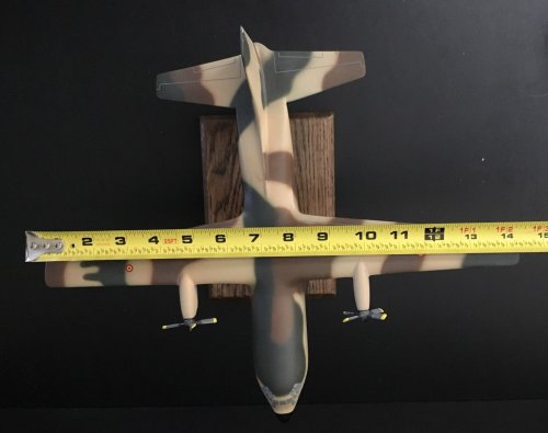

Another sample of L-400 model now on eBay:
http://r.ebay.com/ZcBzlP

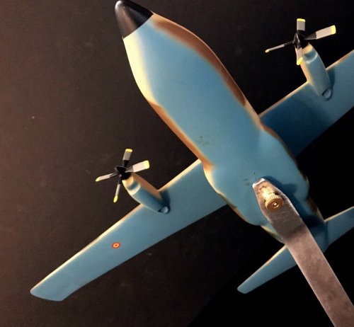

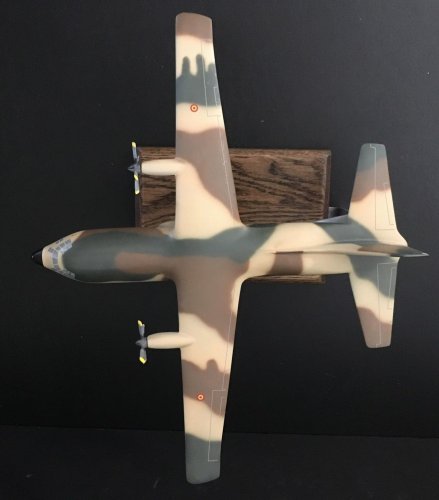

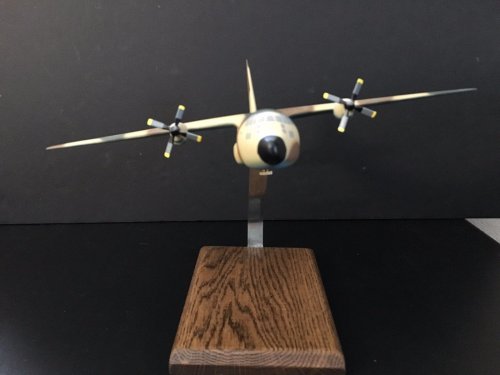

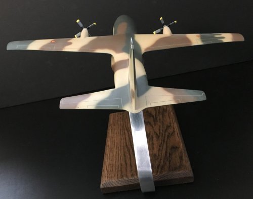

Lockheed L-400 (twin engine C-130 concept) in Spanish Markings
Background: The Lockheed L-400 was designed to serve the needs of a large number of Hercules operators for an economical airlifter for shorter range, lower payload missions. Studies began in the late 1970s. Several options—including a new aircraft—were considered, but a twin-engine derivative of the Hercules was seen as the most logical. The L-400, which would have been built on the C-130 assembly line in Marietta, Georgia, was expected to offer more than ninety percent spares, facilities, mission equipment, and support services commonality with the C-130. The program was officially launched in January 1980 with first flight expected by 1982 and, after FAA certification, delivery to the first customer by 1983. However, the market never developed and the program was shelved by the mid-1980s.
Model photos on http://www.secretprojects.co.uk/forum/index.php/topic,1750.msg275933.html#msg275933
From; Lockheed C-130 Hercules The World's Favourite Military Transport
