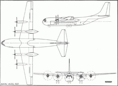

Hi all, since I'm new here, i feel obliged to post something for a start :). I choose this topic, that's going unanswered till now. Here's a fine 3-view of the Boeing submission. Source: Naval Institute Press's Boeng Aircraft since 1916. Data that I have: Four P&W T-34P-6 (5700 HPs each), Span 140 ft, lenght 112 ft 10 in, gross weight 143.500 lbs
Regards!
  • Boeing_Model_495.tif
Regards!
I just wanted to mention that your 260KB .tif file would only be 48KB as a .gif.

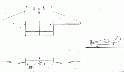

Thanks dan_inbox! Actually yhe design wsn't Burnell's strictly speaking. Airlifts Inc. in lat '40s acquired the CBY-3 Loadmaster (built by Canadian Car and Foudry in 1945) with design rights. The AW articke says that Airlifts proposed a scaled-ud design, I assume a scaled-up CBY-3. In the end, could be it was similar to the 1953 Burnelli original design. I think something can be found in patents.

Re: The "real" YC-130 competiton ?
Bibbidee, bobbidee, booo...

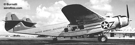

The Burnelli CBY-3 Loadmaster was intensively studied by Fairchild in the early fifties. They had licence production for an improved version in mind.
The Ballard Corporation studied also two improved Loadmaster variants. (Loadmaster II and III). The III version had longer wings and was a turboprop powered design.
In 1950 Burnelli proposed 2 turboprop freighter designs. The CB-7 and the CB-8. Both designs had large rear loading doors and were were driven by two contraprops. I found no relation yet to the C-130 competition.
Boeing model 495 of 1950 was a known contender. Fairchild YC-119H Skyvan was also in the competition but Fairchild had also a four engined derivative of the C-119 in the game.

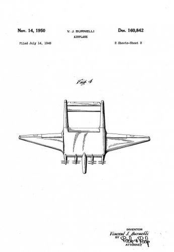

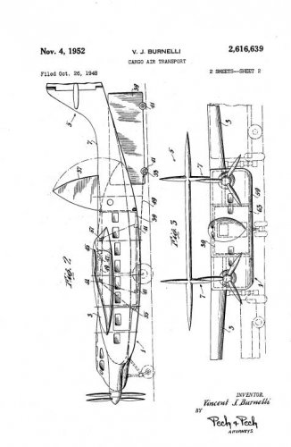

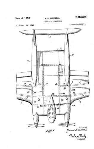

Moreover, the patent I found yesterday is clearly one of the two Latrk cited: CB-7 and -8. Today I'll dig more.
As I already said, Burnelli himself had nothing to do with the C-130 competition. Airlifts Inc (from Florida, BTW) had, via a derivative of the CBY-3 they bought with rights on the desing in late '40s.
AW article explicitly says that Farichild (along with Martin, North American and Northrop) declined to enter the competition. Probably they had a four-engine C-119 study ongoing, but they thought the C-119H was a more clear possibility. Or it could be that the four-engine aircraft attributed to Fairchild was really a Chase one... FOIA, FOIA, we need FOIAs every time... ???

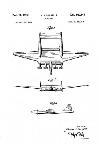

Re: The "real" YC-130 competition ?
And this is the four-engine beast (CB-8 ?)

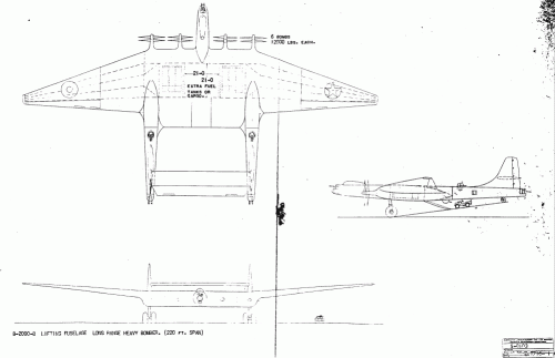

Lookin' very much like the Canadian Car&Foundry B-2000B SuperBomber. This 222ft span aircraft was the CCF 's proposal in the 1942 B-36 competition. Power : 8 Allison 3420 coupled in 4's so that each pair provided 5.000 h.p.
:eek: lark, we need pics of this monster!!!! ;)
Think we need a separate thread devoted to the Burnelli designs...
(not to the conspiracy theories)
SuperBomber.
Power : 8 Allison 3420 coupled in 4's so hat
::BLINKS:: 8 W3420s? That sucker had to be huge to need that much power!! Then again, the B-36 always was a touch under-powered. Hmm...

Sorry Lark, but do you have drawings of the Boeing model 495 and the Fairchild YC-119H Skyvan ???
Regards
Pioneer

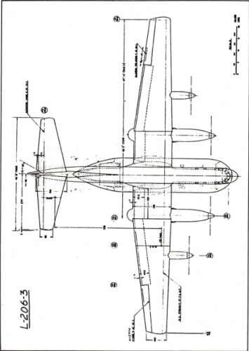

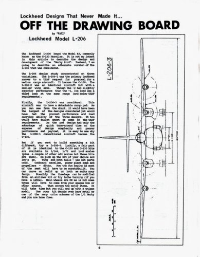

As I said, good topics never die..

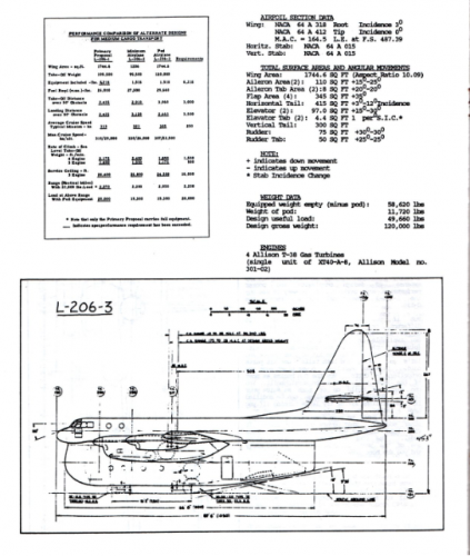

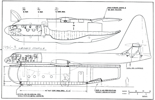

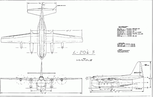

It seems that the other Lockheed proposal was centered around a detachable payload module. It had four turboprops. I'll scan and post the 3-view, which incidentally comes from a Bill Slayton' s article...
Hay Skybolt
What happend?
Are you teasing me??????
Regards
Pioneer
I humbly join the ranks of the supplicants ;) . Show us the three view, pretty please!!!
Sometimes I lapse...
Thanks Skybolt
I never mind waiting for great find like this!
Hay your human after all!!!! ;D ;D
Regards
Pioneer

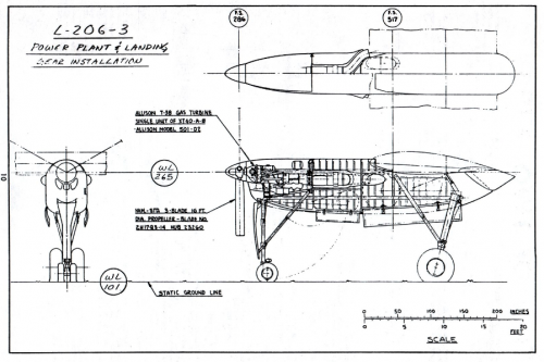

Pioneer said:
Sorry gents, but can anyone tell me where these pics have gone??
Well as usual, the pictures were linked instead of attached. And so when the site goes down, temporarily or permanently, they no longer appear.
The site in question here displays an "Undergoing revision" sign when you try and access the photos directly. In all likelihood the pics (if they are kept in the new version) will probably have changed names or be moved around.
