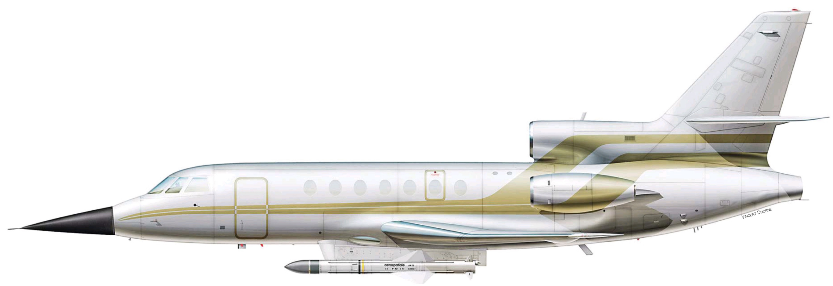

Well, the Iraqis. Or so it seemed. They were hungry for Exocets platforms, but Mirage F1EQ-5 / 6 were late in the game. So they got Super Frelons choppers, then 5* Super Etendards, then this contraption. It worked quite well, but of course against even a F-5E it would have been toast.

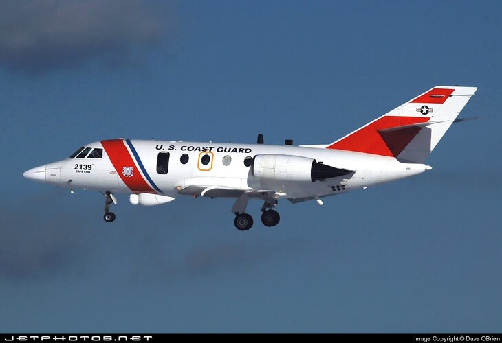

The US Coast Guard flies Falcon jets on long-range search and rescue missions. Falcon's primcipal advantage is its fast cruise speed to reach survivors in mid-ocean hours earlier than C-130s or helicopters. After locating survivors, then drop survival equipment like life rafts. Falcons carry extra sensors (e.g. FLIR) to help locate survivors and extra radios to cover the full spectrum of civilian rescue radios. Unfortunately, they don't have external hard-points capable of dropping SCAD, so they had to cut a hole in the floor of the cabin pressure vessel and hand-drop life rafts, etc. to survivors.

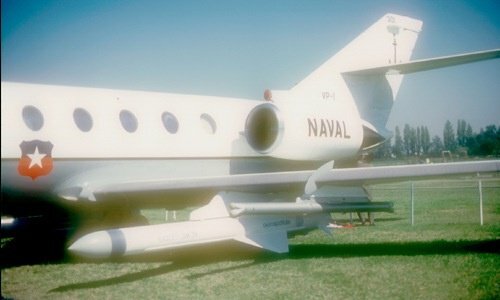

Dassault also had that modified Falcon for the Iraqis, but it is quite significative they never pushed more Falcons into military service beyond the missions I listed above.

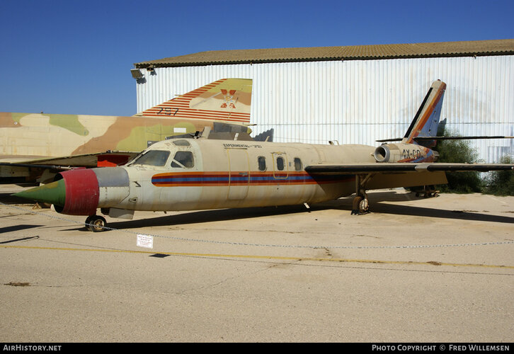

IAI 1121 Jet Commander (4X-COA, 71) used as testbed for MiG-21-2000 radar.
  • IAI 1121 Jet Commander (4X-COA, 71) at Beersheba - Hatzerim, IAF museum (23 December 2012).jpg

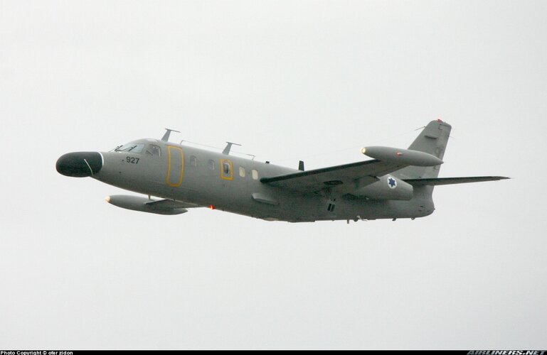

IAI-1124N Seascan :)
  • Israeli IAI-1124N (927, 185) after take-off at Tel Aviv - Ben Gurion (21 December 2004).jpg

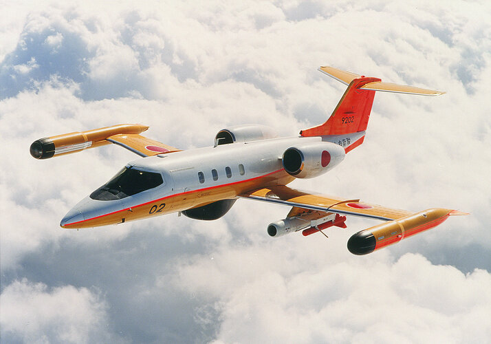

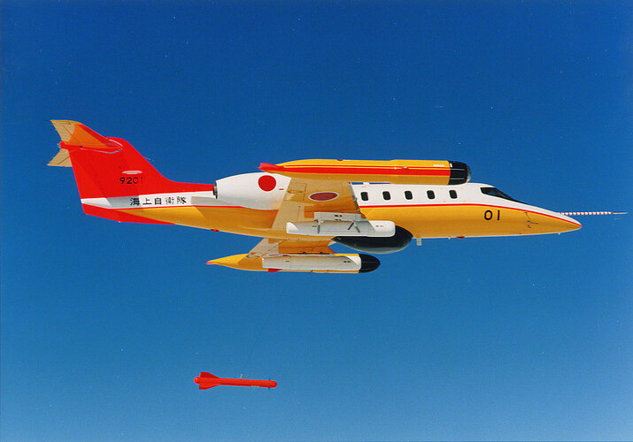

U-36A
Utility transport, training version of the Learjet 35A. Equipped with a missile seeker simulator in addition to a radar, avionics, firing training assessment devices, an ejector pylon, a special communications system, a target towing system and a jammer system. Six were built for the Japan Maritime Self-Defense Force.

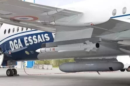

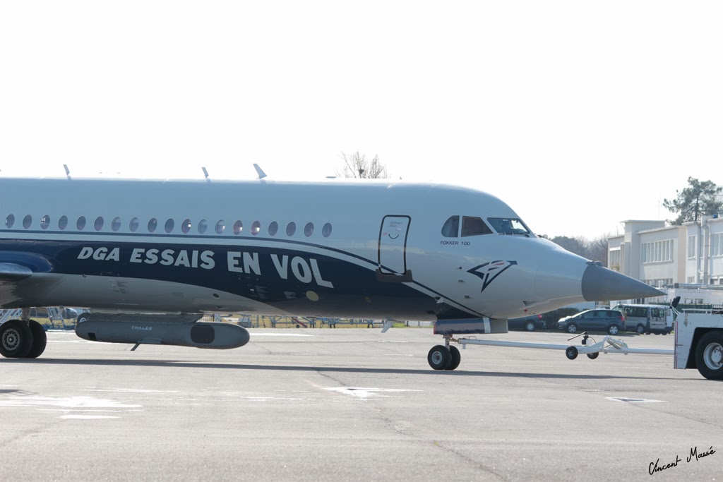

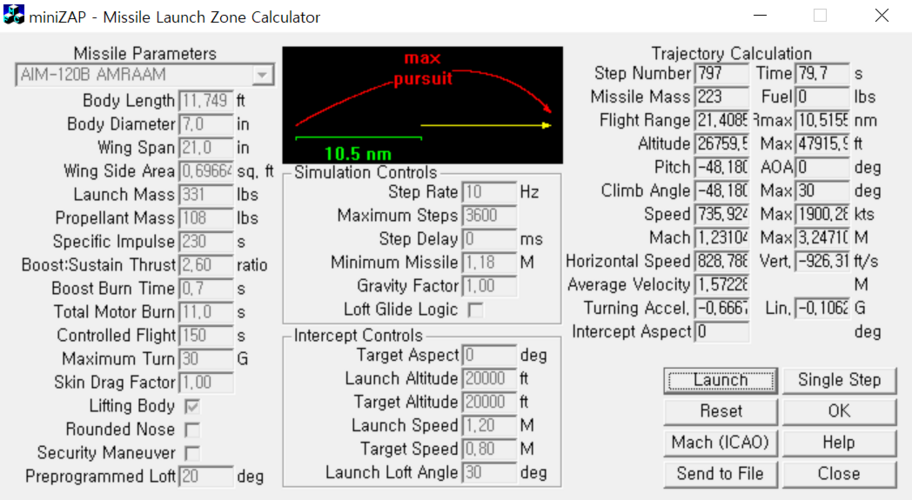

BTW, minizap made by Andrew Pavacic shows that a Mach 1.2 fighter at 20,000 feet should close to within about 10.5 NM to hit a co-altitude Mach 0.8 bizjet running away with an AIM-120B (30 deg loft).

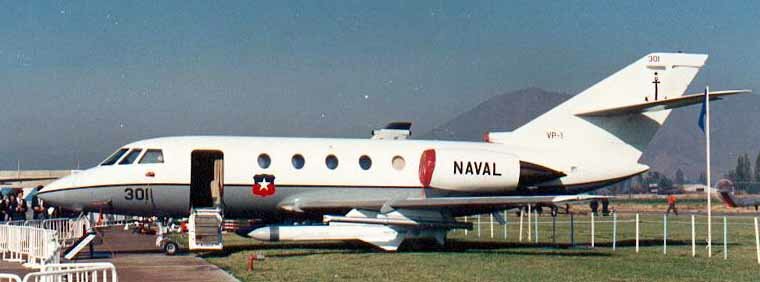

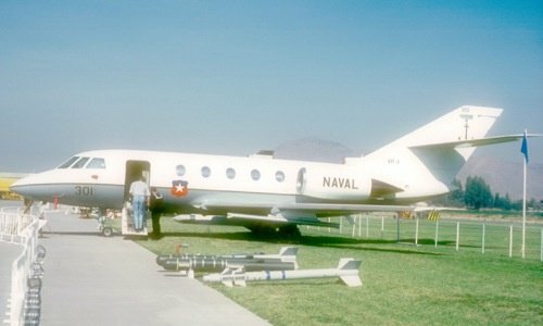

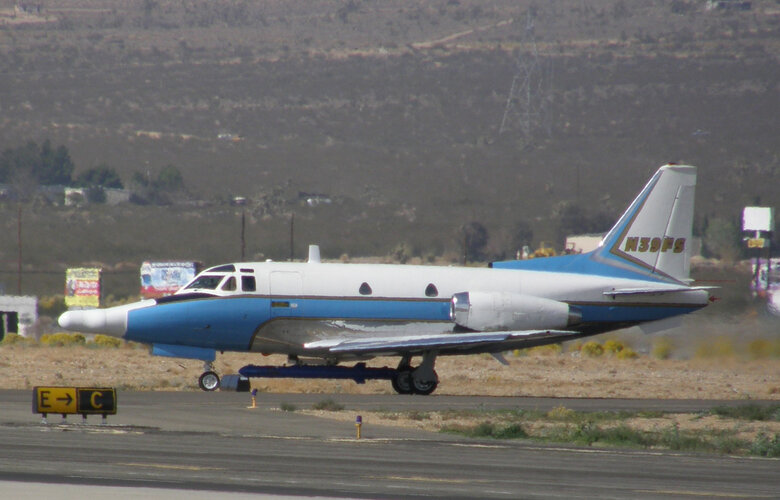

Interesting things :
BAE Systems T-39A. It seems to have a radar and a strange missile. Does anyone know what it is ?
