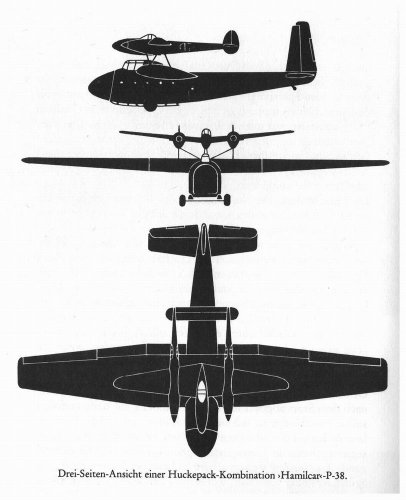

From J.E.Mrazek, "Kampfsegler im 2. Weltkrieg" (Assault glider in WW II) a drawing of the
proposed Hamilcar/P-38 combination:
