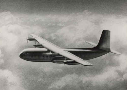

Not often I'm flummoxed, but the attached image has me stumped. Any ideas what this could be? It has a stamp on the back that reads
'DE HAVILLAND PHOTOGRAPH No 446/A'
Might be DH, might not be. The flappery and engine spacing suggest something tactical, as does its apparent size. There is no date on the photo.
Your mission is to proceed up the Nung River identify this project.
Thanks
Chris

It looks very much like a development of the Breguet 941.

Aye, configuration-wise, but the mystery type is much bigger.

Jean Cuny's Breguet book might offer some answers. I'll have a look later.
Ah, mystery solved.
https://www.flightglobal.com/pdfarchive/view/1959/1959%20-%200971.html?search=Breguet
It's a DH Gnome-powered Breguet 941. How bizarre, looks much bigger than a 941.
Thanks for the steer, Arjen!
Chris
One of the worse artists' concepts I've seen. It does look C-130-sized. Maybe the Brits lost interest when they realized it could carry 12 dwarves and a Mini-Moke, or the French lost interest when they realized the engine was a T58.
The real reason I got excited was that I had seen those nacelle/intake designs before - on a Britannia, so...if those were Proteus engines...this beast was something interesting. But no, Ockam's Razor again.
Boo hoo.
Chris

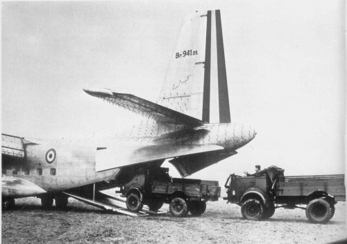

Image from 'Les Avions Breguet 1940-1971' by Jean Cuny and Pierre Leyvastre, Collection DOCAVIA, Editions LARIVIERE
