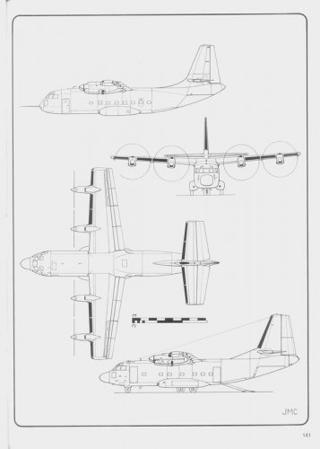

Also would anyone have a high resolution profile blank/drawing of the Breguet 941S?

According to Jean Cunys "Les Avions Breguet", the cargo hold was 10.9 m long, 2.45 m wide
and 2.25 m high. Those data were given for the Br.941, but there weren't changes with regards
to those dimension in the 941S, I think.
The attached drawing, showing the 941S and a side view of the 941, has a resolution of 2000
x 2800 in my scan, can sent it via mail, if it's helpful.
