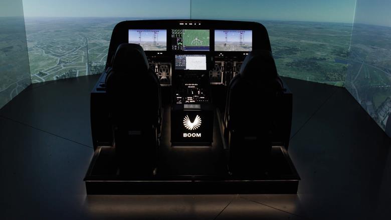

Boom Overture flight deck mockup
Interestingly, the seating position gives only the pilots a very low profile regarding to forward visibility
Remarkable also, are the force feedback side sticks and the newly* announced HMD with see-through camera view (probably another expensive gadget).
*if my mem stands right
