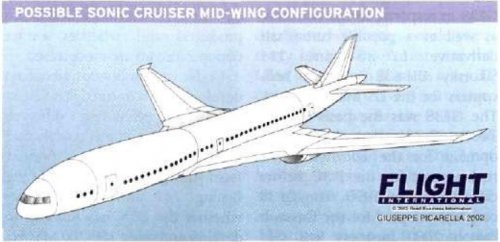

the Boeing company studied many designs airliner and business jet
aircraft,here is possible of sonic cruiser mid-wing configuration
project.
http://www.flightglobal.com/PDFArchive/View/2002/2002%20-%202818.html

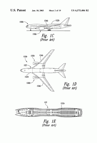

The actual Boeing's configuration for a (more) conventionally looking transonic was totally different, like a waisted 777...

Waisted B-777 from the Flight mentioned patent.
It's not so simple to have a wide-body and a transonic too.... ::) That's why they went to the rear placed wing, shifting the area ruled zone AFT the main cabin.
