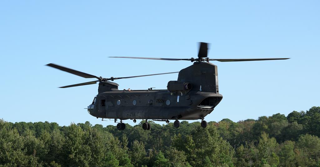

The NCH-47D Chinook testbed helicopter has flown for the first time with the more powerful GE T408 engines of the CH-53K. :cool:
Source / Link: https://www.thedrive.com/the-war-zo...ful-t408-engines-has-flown-for-the-first-time
Let's not forget that Chinooks still fly with a symmetrical airfoil that could need to be replaced to get use of all that extra power (50% more). Otherwise engine swap won't affect positively any perfs, except, probably, fuel consumption.
(the last rotor modernisation brought only minor improvements)

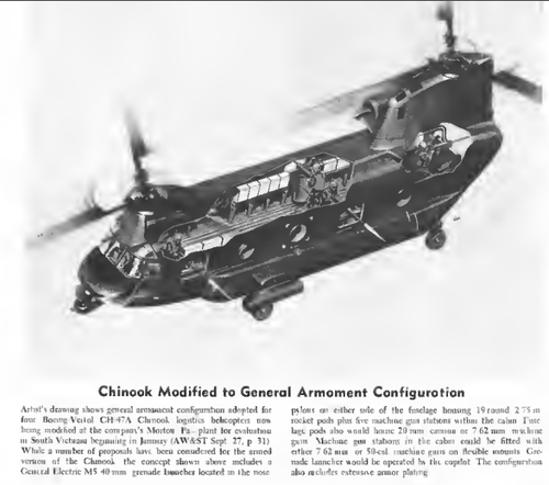

The ACH-47 "Armed/Armored Chinook was always proof positive that the Chinook was too small to support armed insertion of troops into hostile LZs. One could not supress hostile fire and still carry troops. One had to make a choice.

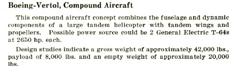

The Gnome Chinook was not the only version proposed by Boeing-Vertol to meet the Air Ministry's ASR.358.
The company offered a CH-47A fitted with two General Electric 2,60shp T64-GE-6 turboshafts both to West Germany and the UK in mid-1964.
The T64 was rotated inwards by 10 degrees which moved the nacelle closer to the fuselage and improved access for maintenance.
It looks as though a study was also made using the T64-GE-53 rated at 3,045shp, which I think was a paper engine and the first of the 3,000shp T64 designs. BV also indicated that GE were working on a future 3,300shp model.
Boeing-Vertol and GE seemed to have in mind a deal whereby Bristol Siddeley would build 40% of the T64 under licence for German Chinooks, hoping the Admiralty would lessen its engine-out requirements and accept two T64s instead of four Gnome H.1600s (neither dream became reality).
By mid-1964, India, Italy and Japan had all received proposals from Boeing-Vertol for the CH-47A (Australia had ordered in 1962 but cancelled due to budget issues) - all three eventually becoming buyers after a number of years.
