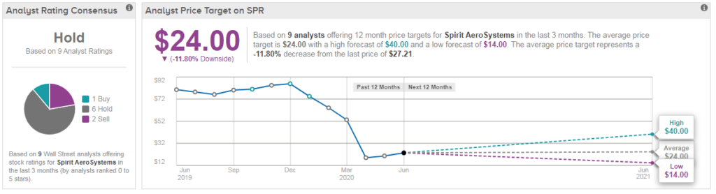

Boeing cut 737 production by ~50% pushing Spirit aero on the verge of collapse.
https://finance.yahoo.com/amphtml/news/spirit-aero-falls-hours-financial-064711044.html
It's pretty far from "on the verge of collapse" as it won't hit the issue until Q4, so 3-6 months from now depending when the payments are due - generally end of the quarter in the UK, not sure about the US. Renegotiating debt repayments probably covers 80% of companies right now (including Boeing which has used up a $14Bn loan facility and then raised $25Bn more by a bond offer it'll need to pay off at some point). I'd fully expect Spirit to successfully renegotiate terms, though it may have to make further redundancies. It's the smaller suppliers who are probably more at existential risk, little companies with niche products that no one else makes and who are entirely dependent on aerospace for income, but don't have the financial weight of a company the size of Spirit when it comes to renegotiating their debts.
Few more details in the Reuters report: Boeing's order to Spirit for MAX/P-8 fuselages is down from 216 at start of the year to 125 in May to 72 now, and it's already delivered about half of those.
https://uk.reuters.com/article/us-s...after-deeper-737-production-cut-idUKKBN23T368
