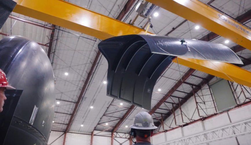

Unless your entire airframe is composites (not a small ask), you're still bucking rivets on the internal frames.
Probably depends on the application. From my tiny corner, Rosie the Riveter seems like a thing of the past. What few solid rivets I see we squeeze, and most of those have blind alternates. Titanium fasteners rule the day with the occasional CRES bolt for stupidly tight areas.
Majority of the BWB demonstrator will probably by bonded structure with possibly composite/metallic sandwiched combos fastened with Hi-Loks for critical loaded areas. If Scaled can bond everything together they will and they have had numerous successes with bonded large structure, example, the Roc/Stratolaunch aircraft.

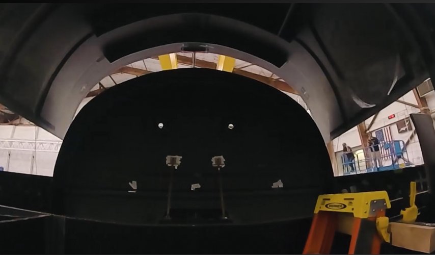

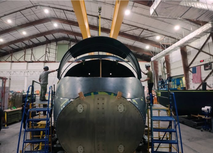

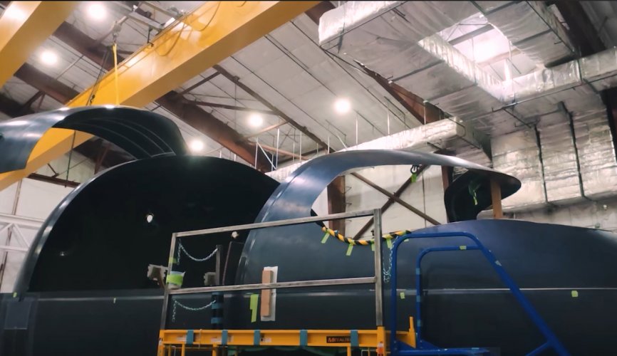

That is one BIG demonstrator!
Assembly of the 178 ft. wingspan, 260,000 lb. gross weight demonstrator is progressing at partner Northrop Grumman’s Scaled Composites subsidiary.
Admittedly, it's using a pair of 757 engines so a certain level of size should be expected. But I was not expecting 260klbs gross!

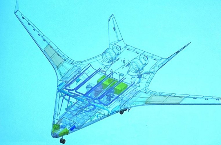

In one of the images on the JetZero media site, you can see a refueling boom peeking out from underneath.
Might make a nice offensive/defensive missileer as well.
I'd say it's mostly aerodynamically motivated, as nothing about this aircraft is particularly "LO". Possibly for improved low speed control upon take off and landing.
That is fair enough.
That said, an existing tanker or transport aircraft is going to be in the vicinity of 100-150 sq. m. RCS. If the new shape and a few RCS reduction measures (e.g. a compromise RCS reduction coating that balances maintenance with stealth) it could allow reducing the RCS closer to B-1 bomber levels... maybe even a bit below that - which would potentially reduce the range for extreme BVR acquisition (e.g. PL-17 / AIM-260 class weapons) - which would then give more time for escort fighters to intercept that attackers...
Dedicated vertical tail surfaces on the "fuselage" could also reduce loads on the wingtips, allowing for overall lighter weight. They could also be bigger, which would be beneficial if this aircraft is actually supposed to cruise above 40k ft (although refueling at that altitude might not be possible).
Which is totally fair, although I doubt it heavily due to the engines.
But that aside, I think nobody would call the B-1B a low observable aircraft.
It's undeniable that the JetZero proposal will reduce it's signature across several spectrums if it gets adopted by the US. I just don't think we should focus on that in the discussion, because it's clearly not the focus of the design either. Aerodynamic efficiency, internal volume, full scale flight tests, I think these are the most important aspects of it's development right now.
It is though. It was part of the requirement - to have a reduced RCS to increase its ability to penetrate defences. The B-1A was cancelled because it was too easy to detect (and efforts were already heading to the ATB/B-2 program) and when the B-1B was ordered it was intended to have RCS reduction features to give it some of the penetration capability. It had serpentine ducts and radar absorbent materials to lower its RCS by an order of magnitude (to something closer to that of a contemporary fighter aircraft).
By that measure something like the Eurofighter is low observable too. Incorporating features to achieve signature reduction doesn't warrant the "low observable" label, at least not in the way it's generally applied (to aircraft which went to great lengths to reduce their signature with regards to radar and thermal detection as well as emission of signals that could be picked up by ELINT/SIGINT assets).
I think the official term is "reduced observable" when you're talking 10-20db aka 1-2 orders of magnitude. Which is about all you can achieve without dedicated shaping.
Pardon me, should have responded to this earlier.
Those images are very close to a cranked-kite (X-47B) shape, which is pretty solidly LO.
Keep the canted ruddervators, shift to non-tapering wings, bury the engines, and sharpen some chines. That should give you 4 major glint angles in the front arc, plus another glint off the ruddervators abeam the aircraft.
Buried engines will cost you a big chunk of interior volume, however. Could an inlet spike work for RCS at subsonic speeds?
Unless there's some black magic shenanigans in the relationship between the two major angles per side that causes the fuselage chine glint and wing glint to collapse into a single glint at range due to constructinve/destructive interference? That would be fun. Way above my paygrade to figure out, however. Who on the forum understands radar or sound well enough to help figure that out? @stealthflanker is that your interest?
They said in the AvWk article that they moved the tails to the "Fuselage" because they offered better yaw control (longer lever arm from the center of mass) and they shielded the noise from the engines. I would add that it would undoubtedly make the wings lighter/more efficient, by not having the rudders at the tips.
