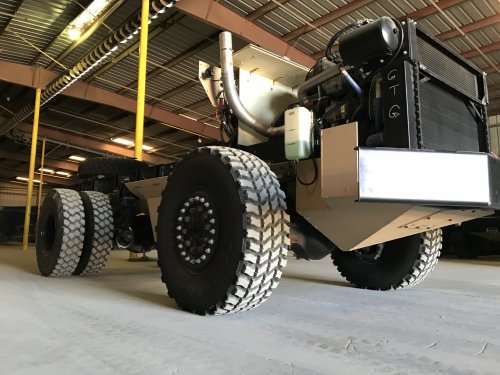

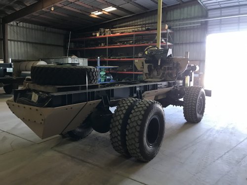

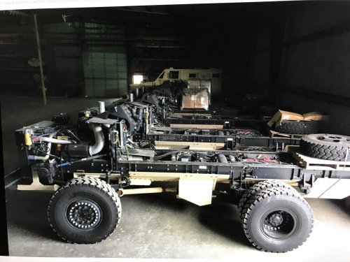

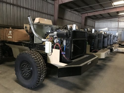

Recently, on the website Bring a Trailer a listing appeared for a military project based on a Seagrave chassis with center driving position.
I did some digging and found out it was produced by a Blackwater-ARES joint venture. The Grizzly APC1 was built by Blackwater Armored Vehicle and equipped with ARES EXO Scale appliqué armor.2 This vehicle is listed as a 4x4 contender in the MRAP II program.3 In March 2008 ARES stated its armor passed live-fire testing.2 However, vehicle was later disqualified in June because of limited armor protection in the frontal area.4
Later that year, after also losing the JLTV contract they shut down all vehicle manufacturing.5 Now these are being sold off. The Hemmings seller South Jersey Classics had 6 units and have subsequently sold for a bargain US$19,900, each. Imagine what they bought them for! The question remains how many Grizzly APCs were built in total.
Specifications (from seller)
Engine: Caterpillar C7 / 3126E Turbo Diesel
Output: 330HP at 2400 RPM, Torque 800 ft/lb at 1400 RPM
Transmission: Allison 300SP 5 Speed automatic
Torque Converter: Allison TC418
Transfer case: ?

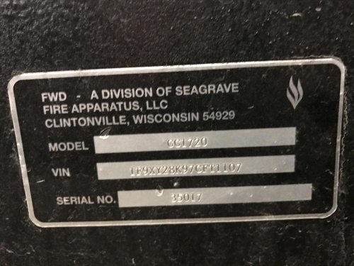

Chassis: Seagrave Variable Section Frame, "120k psi" [120,000 PSI yield strength across the entire frame]
Axles: Meritor
Ratio: 6.14:1
Front Suspension: 19,000 lbs [brand, model?]
Rear Suspension: 23,000 lbs [brand, model?]
Wheels: Hutchinson run flat 20" x 10" 10 bolt
Tires: [Goodyear] 395/85R20
Dimensions: Length - 22.5ft; Width to outside of tires - 98inches; Frame width - 45 inches
Wheelbase: 11ft

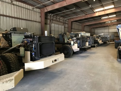

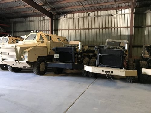

Rare opportunity. Originally ordered for the military. Built in 2008 and never used. I have 6 units available all the same and they all have less than 5 miles! All run and drive and only need bodies. There fully wired and drivable. Also comes with titles for each unit. Each Chassis was $79,000! Build something amazing!!!!
