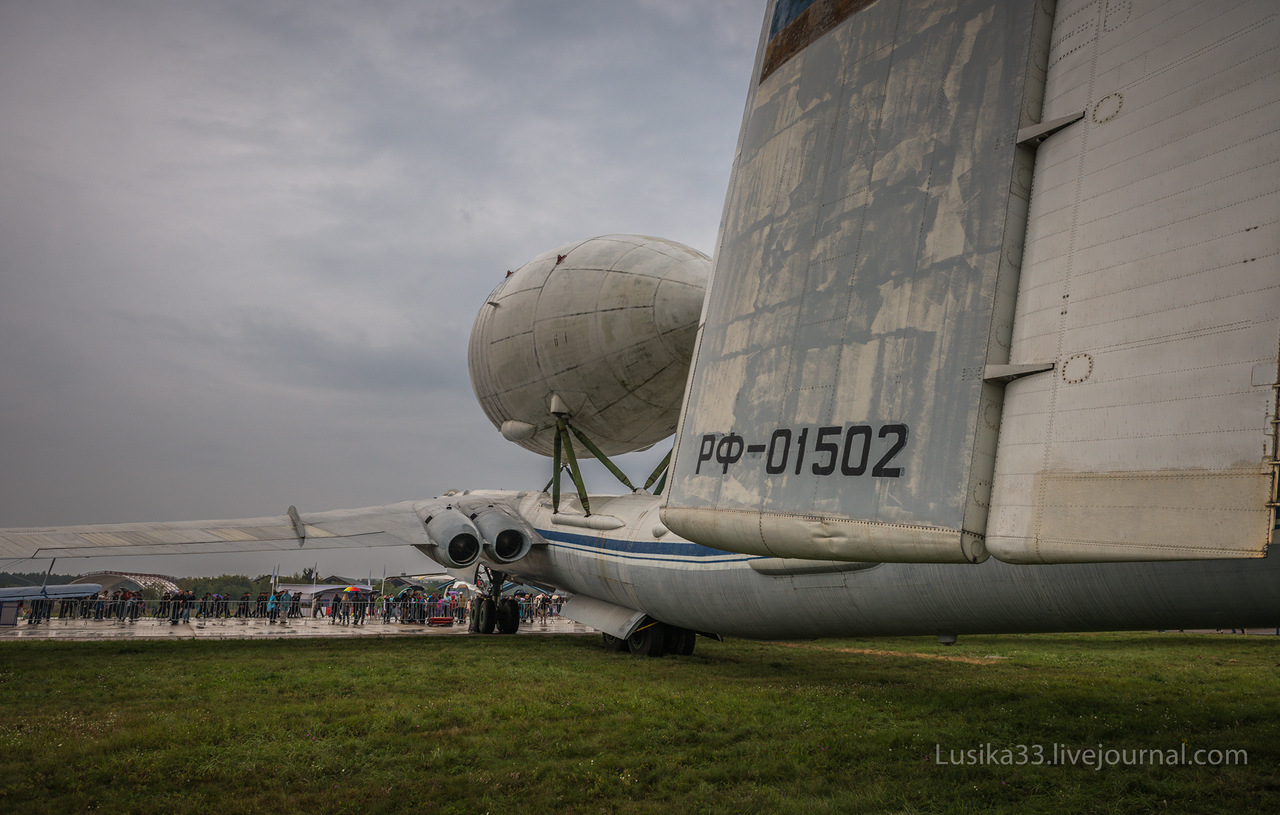

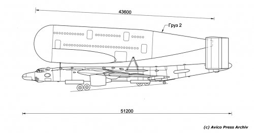

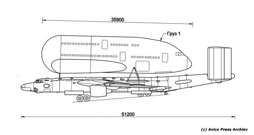

On April, 6, Myasishchev EMZ will start consultations with Airbus, an EADS company, on developement of folow-on to Airbus A300-600ST Super Transporter, widely known as Beluga. New airplane is intended for transportation of A380 fuselage and wing parts to Toulouse, France.
EMZ offer is a modification of VM-T Atlant (3M-T), used for Energia launcher components and Buran orbiter transportation in late 80s. VM-T modifications were recently performed at Ryazan aircraft repair factory.
New project got Beluga-2 designation.

according to ucon's drawings, it's going to be re-engined with PW4168A engines.
cheers,
Robin.

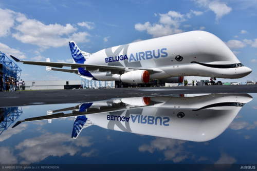

You would think a Beluga2 would be more likely an A380 derivative, to capitalize on infrastructure and design work that went into the original Beluga...
Airbus has already built a new-generation Beluga freighter based on the Airbus A330. Guess the joint Myasishchev-Airbus proposal for using the M-4 to transport A380 fuselages was a bit technically risky to be a practical proposition.
