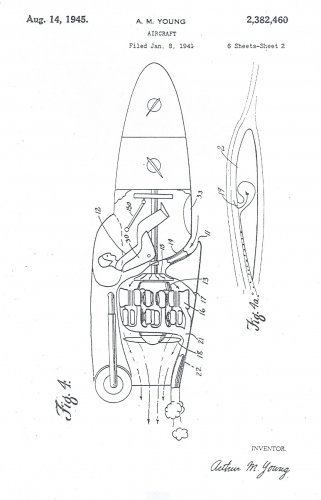

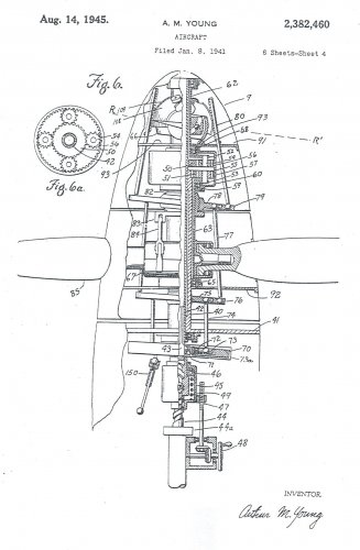

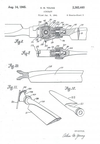

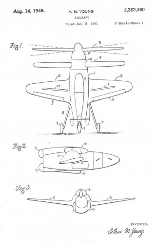

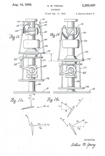

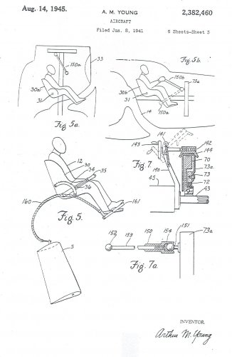

1°) Arthur M. Young was the engineer who introduced Bell to rotorcraft with what became the Model 30.
2°) He was in charge with all the helicopter and VTOL projects at Bell throughout the 1940s.
3°) He filed a patent in 1941 for an "Aircraft" which was a jet convertible helicopter exactly similar to the artist's view pictured above.
4°) In 1944 the patent was approved.
5°) In 1945, Young was in charge of a Bell project called the "Model 50 Convert-O-Plane", which is said to have been a tailsitter VTOL.
It sounds therefore pretty reasonable to imagine that the Model 50 may have looked somewhat like the 1941 patent submission!
The Model 50 is not to be mistaken (as I once did) for design D-109, also called Convert-O-Plane, which was an early 1951 contender for the VTO fighter competition against the better known submissions such as the Convair Model 5 Pogo-Dart, the Lockheed Model 81 Rising Star, the Northrop N-63 and the Martin 262.
Patent drawings here... ;)

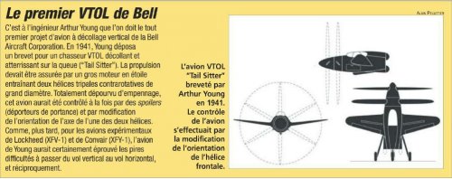

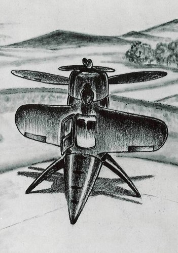

from Le FANA No 521,and by the member "Mirage 4000",here is the Bell tail-sitter aircraft
of 1940s.
