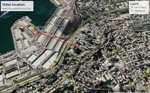

Those small explosives reminds me of Mexico fireworks factory explosion. There could be some stockpiled... maybe. About 1-2 km from port there is Tabarra fireworks factory.
The big explosion however is kind of mystery.
I tried to geolocate where that video was taken and my findings so far it's about 600 m from the explosion. From there i tried to approximate the speed of blast wave from the distance and the arrival of the blast (which i taken to be when the person duck) and it's about Mach 1.8. The overpressure is about 1 PSI (shattered glass, dust) At that distance. The yield of the explosion is approximated to be about 10 Ton of TNT equivalent.
That's a huge amount of boom there.
Correction. It should be 10 metric tonne. not 100. Apologize.

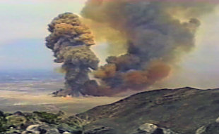

For comparison, this is the explosion following a Saudi attack on a Houthi missile storage site. The "sparkles" seen in the fireball are interesting.

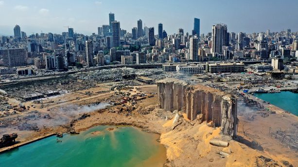

OMFG - I wondered what had happened to the big building near the explosion epicenter. Whether it was launched to the Moon or Jupiter. It is pretty amazing, half of it is still standing.
galgot
Jul 6, 2006
1,097
1,457
galgot.com
That's the grain silo. The grain filled "tubes" facing the explosion must have absorbed enough of the blast for the rest of the thing to stand still.
Indeed a lot of grain must have been blown up the air.
